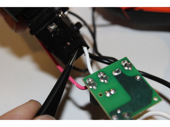

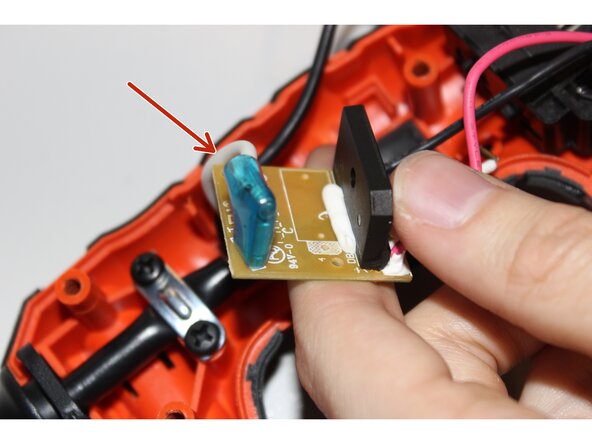

  3. Black and Decker BDEDMT Circuit Board Replacement, Circuit Board: crwdns2935265:03crwdnd2935265:01crwdnd2935265:02crwdne2935265:0 Black and Decker BDEDMT Circuit Board Replacement, Circuit Board: crwdns2935265:03crwdnd2935265:02crwdnd2935265:02crwdne2935265:0
    • There will be a white cord that runs from the power cord base to the circuit board located slightly above.
    • Use the tweezers to detach the entire white cord and blue connection piece as a whole from the circuit board.

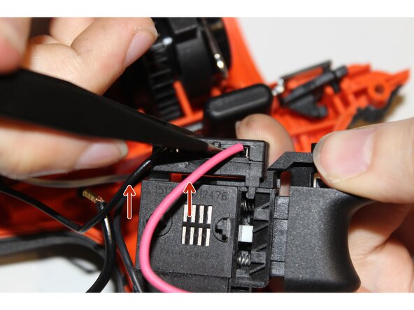

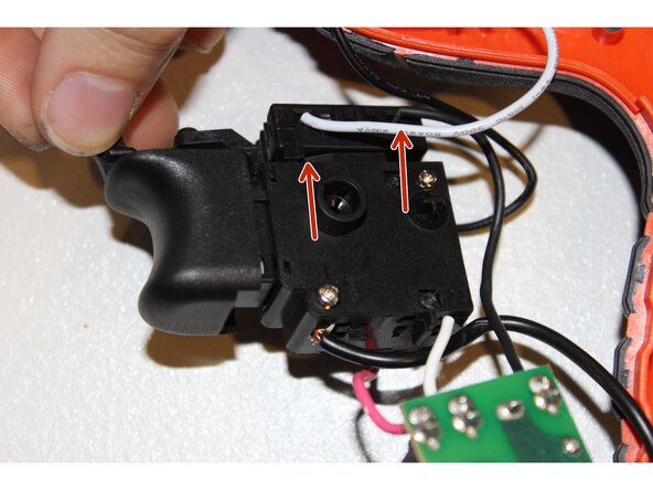

  4. Black and Decker BDEDMT Circuit Board Replacement: crwdns2935265:04crwdnd2935265:01crwdnd2935265:03crwdne2935265:0 Black and Decker BDEDMT Circuit Board Replacement: crwdns2935265:04crwdnd2935265:02crwdnd2935265:03crwdne2935265:0 Black and Decker BDEDMT Circuit Board Replacement: crwdns2935265:04crwdnd2935265:03crwdnd2935265:03crwdne2935265:0
    • There will be one black wire, a thin white wire and a thin red wire connecting to the trigger module from the circuit board. Using your needle nose tweezers insert one of the ends into the release slot below the white wire.
    • Make sure to aim the tweezers toward the wire.
    • Lift the end of the tweezers to release the wire.
    • The Circuit board is now free.
    • Do not force the removal of the wire.
    • Remember to reinsert the wires to their corresponding slots when reassembling.
