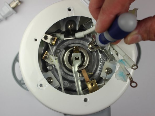

    • Inside the device, there are three junctions with wires joined by Phillips-head screws. The first is connected to two wires, and the other two are connected to three wires each.
    • Unscrew the screw at the junction near the opposite side of the device from the front panel.
    • Label each of the two wires at this junction with a single color of tape.
  8. Black and Decker 3-Cup Rice Cooker Spring Replacement, Label the Second Wire Junction: crwdns2935265:08crwdnd2935265:01crwdnd2935265:02crwdne2935265:0 Black and Decker 3-Cup Rice Cooker Spring Replacement, Label the Second Wire Junction: crwdns2935265:08crwdnd2935265:02crwdnd2935265:02crwdne2935265:0
    • Unscrew the screw at the junction just clockwise from the button panel.
    • Label the three wires of this junction with tape of a second color.
  9. Black and Decker 3-Cup Rice Cooker Spring Replacement, Label the Third Wire Junction: crwdns2935265:09crwdnd2935265:01crwdnd2935265:02crwdne2935265:0 Black and Decker 3-Cup Rice Cooker Spring Replacement, Label the Third Wire Junction: crwdns2935265:09crwdnd2935265:02crwdnd2935265:02crwdne2935265:0
    • Unscrew the screw from the wire junction just behind the front panel.
    • Label the three wires at this junction with a third color of tape.

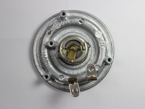

  13. Black and Decker 3-Cup Rice Cooker Spring Replacement, Unlock the Hotplate: crwdns2935265:013crwdnd2935265:01crwdnd2935265:02crwdne2935265:0 Black and Decker 3-Cup Rice Cooker Spring Replacement, Unlock the Hotplate: crwdns2935265:013crwdnd2935265:02crwdnd2935265:02crwdne2935265:0
    • Position a pair of pliers so that they are outside the hotplate's two inner silver-colored rectangular plates.
    • Carefully push the plates together to unlock the inner portion of the hotplate.
  14. Black and Decker 3-Cup Rice Cooker Spring Replacement, Expose the Spring: crwdns2935265:014crwdnd2935265:01crwdnd2935265:01crwdne2935265:0
    • Remove the non-spring portion of the hotplate by lifting it up, exposing the spring and brass locking latch underneath.
  15. Black and Decker 3-Cup Rice Cooker Spring Replacement, Remove the Spring: crwdns2935265:015crwdnd2935265:01crwdnd2935265:01crwdne2935265:0
    • Remove the 47 mm by 30 mm spring, by pulling it up and off the locking latch.
    • If the spring is in multiple pieces, does not compress and spring back easily, or otherwise does not behave like a spring, you will need to replace it.
