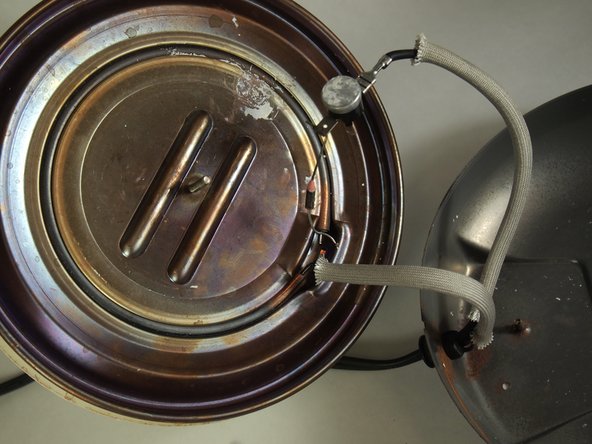

  5. Black And Decker Electric Kettle 8901 0 Disassembly: crwdns2935265:05crwdnd2935265:01crwdnd2935265:02crwdne2935265:0 Black And Decker Electric Kettle 8901 0 Disassembly: crwdns2935265:05crwdnd2935265:02crwdnd2935265:02crwdne2935265:0
    • Remove the bracket holding the heat switch to the body of the device.
    • The heat switch is attached to the kettle with thermal paste. Unless you have this material readily available, it is advised to skip this step.
  6. Black And Decker Electric Kettle 8901 0 Disassembly: crwdns2935265:06crwdnd2935265:01crwdnd2935265:02crwdne2935265:0 Black And Decker Electric Kettle 8901 0 Disassembly: crwdns2935265:06crwdnd2935265:02crwdnd2935265:02crwdne2935265:0
    • You are done with disassembly!
    • Heat switch (metal circle with black bottom attached to wiring)
    • Wiring
    • Heating element (large, circular wiring that wraps around center of kettle)
    • Spacer (metal tube)
    • Thermal fuse (black cylinder with orange top attached to wiring)
    • Metal bracket
    • Hex nuts (x2)
