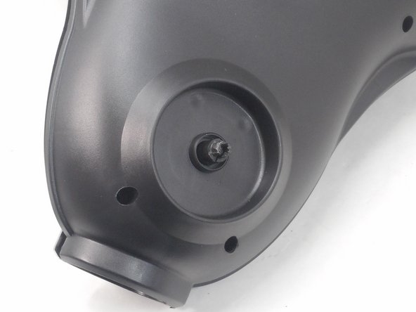

    • Remove the dust tank, so the vacuum can lie upside down easily.
    • Press the grey button while pulling up.
  2. Bissell Zing 2156A Swivel Wheel Replacement: crwdns2935265:02crwdnd2935265:01crwdnd2935265:01crwdne2935265:0
    • Flip the vacuum upside down.

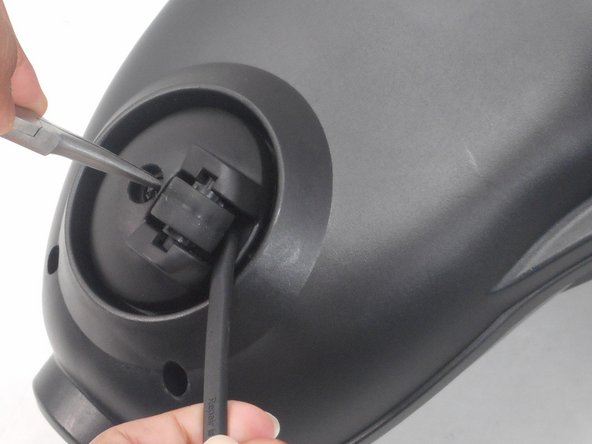

    • Clamp the exposed axis with needle nose pliers to fully compress it.
    • Insert the halberd spudger's hook under the wheel and pry it up while continuing to hold the axis.
    • When the wheel is pried up, pick it up.
    • The plastic axis holding the wheel in place is fragile!
