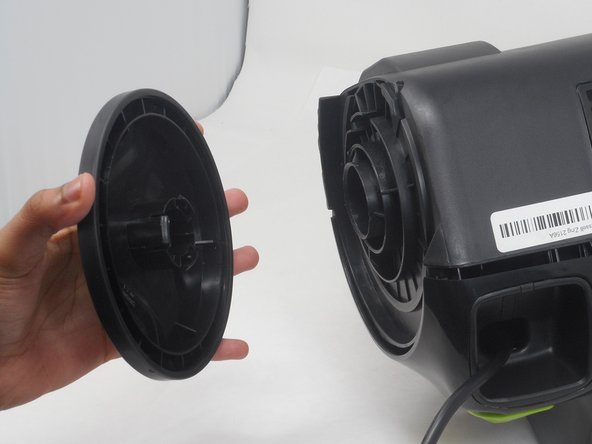

    • Flip the vacuum upside down.
  3. Bissell Zing 2156A Case Replacement: crwdns2935265:03crwdnd2935265:01crwdnd2935265:03crwdne2935265:0 Bissell Zing 2156A Case Replacement: crwdns2935265:03crwdnd2935265:02crwdnd2935265:03crwdne2935265:0 Bissell Zing 2156A Case Replacement: crwdns2935265:03crwdnd2935265:03crwdnd2935265:03crwdne2935265:0
    • Place your hand inside between the wheel and vacuum and pry the wheel off.
    • Repeat with the other side.

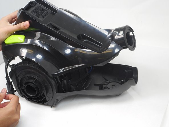

  5. Bissell Zing 2156A Case Replacement: crwdns2935265:05crwdnd2935265:01crwdnd2935265:03crwdne2935265:0 Bissell Zing 2156A Case Replacement: crwdns2935265:05crwdnd2935265:02crwdnd2935265:03crwdne2935265:0 Bissell Zing 2156A Case Replacement: crwdns2935265:05crwdnd2935265:03crwdnd2935265:03crwdne2935265:0
    • Use the spudger to loosen the top case from the bottom. Make sure to loosen it all around the bottom and lift up.
