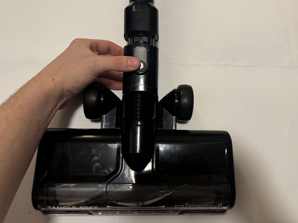

    • Detach the head assembly of the vacuum by pressing down on the grey latch and pulling downward, releasing it from the main vacuum unit.

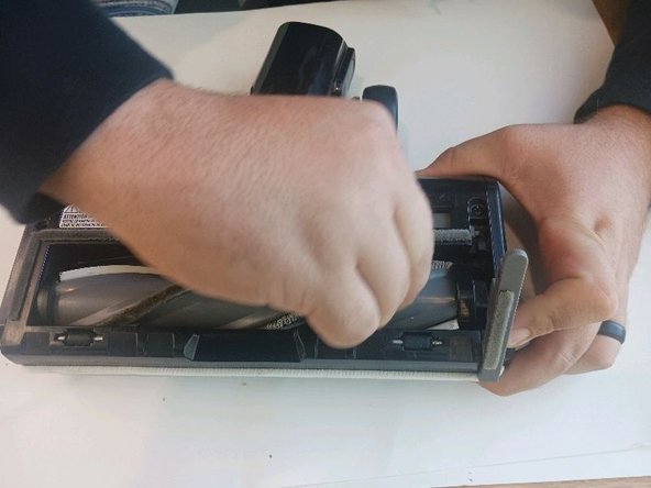

  5. Bissell Vacuum Belt Replacement and Motor Inspection, Remove the Brush Roll Belt: crwdns2935265:05crwdnd2935265:01crwdnd2935265:01crwdne2935265:0
    • Remove the belt by gently "walking" it off the pulley. To do this, move the belt towards the driven pulley while pulling it towards yourself. Repeat this motion until the belt is fully off the pulley.
    • If you are only replacing the belt, you can skip to the conclusion. Continue forward for steps on disassembling for motor inspection.

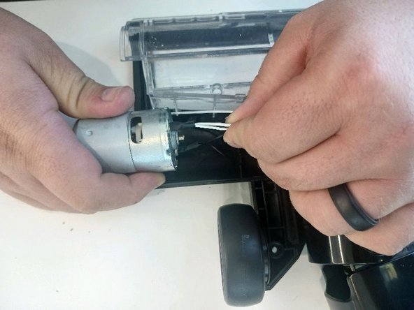

  10. Bissell Vacuum Belt Replacement and Motor Inspection, Inspect the Motor: crwdns2935265:010crwdnd2935265:01crwdnd2935265:02crwdne2935265:0 Bissell Vacuum Belt Replacement and Motor Inspection, Inspect the Motor: crwdns2935265:010crwdnd2935265:02crwdnd2935265:02crwdne2935265:0
    • Inspect the motor and wire connections for signs of damage on or in the motor. This includes frayed wires, loose connections, burn marks or smells, or excessive wear.
    • If the motor is malfunctioning or the wires are severely damaged, consider replacing the motor or getting a new vacuum. Motor replacement will require desoldering.
