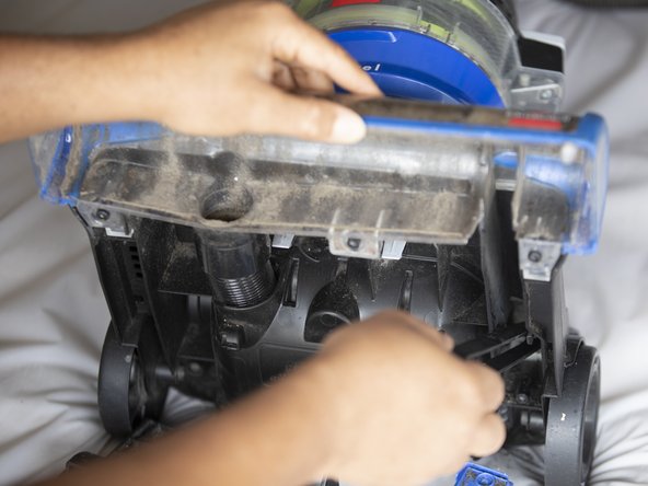

    • Using your Phillips #2 screwdriver, remove the six 17.5 mm screws on the front panel that holds the brush roll in place.

    • Pull the front panel to remove it and access the brush roll and the broken belt.

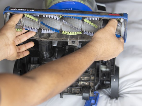

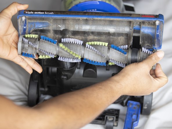

    • Remove the broken belt.
    • Hold the brush roll on both ends and pull it outward to remove it.

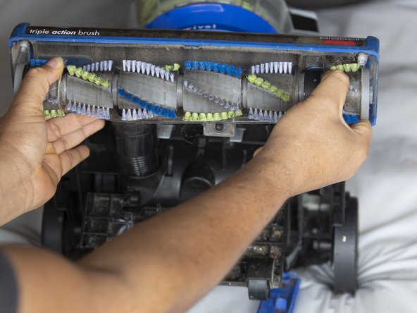

    • Put the new belt on the metal that makes the belt turn. It is located close to the rear tire.
  5. Bissell Swivel Rewind Pet Vacuum Belt Replacement: crwdns2935265:05crwdnd2935265:01crwdnd2935265:02crwdne2935265:0 Bissell Swivel Rewind Pet Vacuum Belt Replacement: crwdns2935265:05crwdnd2935265:02crwdnd2935265:02crwdne2935265:0
    • Put the new belt on the brush roll where there is a black spot.

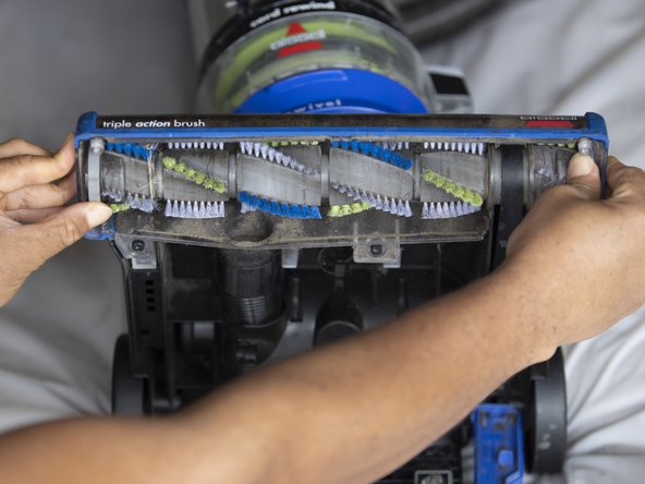

    • Pull the brush roll upward and align it in its original spot.
    • This may take some force.
