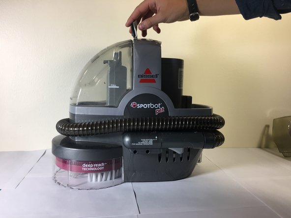

  2. Bissell SpotBot Pet Control Panel Replacement: crwdns2935265:02crwdnd2935265:01crwdnd2935265:01crwdne2935265:0
    • Remove the container on the right side of the vacuum.
  3. Bissell SpotBot Pet Control Panel Replacement: crwdns2935265:03crwdnd2935265:01crwdnd2935265:02crwdne2935265:0 Bissell SpotBot Pet Control Panel Replacement: crwdns2935265:03crwdnd2935265:02crwdnd2935265:02crwdne2935265:0
    • Lift the tap on top of the vacuum, and then remove the container on the left side of the vacuum.

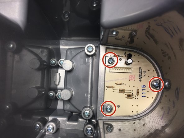

  9. Bissell SpotBot Pet Control Panel Replacement: crwdns2935265:09crwdnd2935265:01crwdnd2935265:02crwdne2935265:0 Bissell SpotBot Pet Control Panel Replacement: crwdns2935265:09crwdnd2935265:02crwdnd2935265:02crwdne2935265:0
    • Remove the screws holding the motherboard in place.

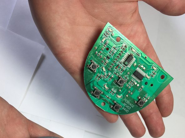

  10. Bissell SpotBot Pet Control Panel Replacement: crwdns2935265:010crwdnd2935265:01crwdnd2935265:02crwdne2935265:0 Bissell SpotBot Pet Control Panel Replacement: crwdns2935265:010crwdnd2935265:02crwdnd2935265:02crwdne2935265:0
    • Remove the motherboard from the top piece. Repair or replace the motherboard if it is faulty.
