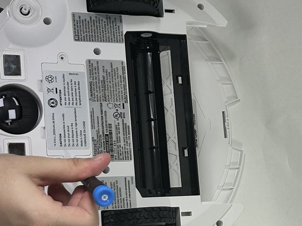

    • Place the Bissell Spinwave pet upside down.
  2. Bissell Spinwave Pet Battery Replacement: crwdns2935265:02crwdnd2935265:01crwdnd2935265:01crwdne2935265:0
    • Use a Phillips #00 screwdriver to remove both screws.
  3. Bissell Spinwave Pet Battery Replacement: crwdns2935265:03crwdnd2935265:01crwdnd2935265:02crwdne2935265:0 Bissell Spinwave Pet Battery Replacement: crwdns2935265:03crwdnd2935265:02crwdnd2935265:02crwdne2935265:0
    • Remove the two secondary brushes.

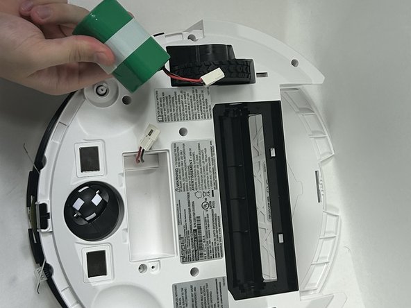

  4. Bissell Spinwave Pet Battery Replacement, Battery: crwdns2935265:04crwdnd2935265:01crwdnd2935265:02crwdne2935265:0 Bissell Spinwave Pet Battery Replacement, Battery: crwdns2935265:04crwdnd2935265:02crwdnd2935265:02crwdne2935265:0
    • Use a Phillips #00 screwdriver to remove the two screws from the battery panel.
  5. Bissell Spinwave Pet Battery Replacement: crwdns2935265:05crwdnd2935265:01crwdnd2935265:01crwdne2935265:0
    • Remove the battery cover.
    • If the battery cover is difficult to remove, use a spudger to gently lift the edge before attempting again.
    • Pick up the battery from the compartment.
  6. Bissell Spinwave Pet Battery Replacement: crwdns2935265:06crwdnd2935265:01crwdnd2935265:02crwdne2935265:0 Bissell Spinwave Pet Battery Replacement: crwdns2935265:06crwdnd2935265:02crwdnd2935265:02crwdne2935265:0
    • Squeeze the tab against the connector and pull the two sides apart to disconnect the battery.
