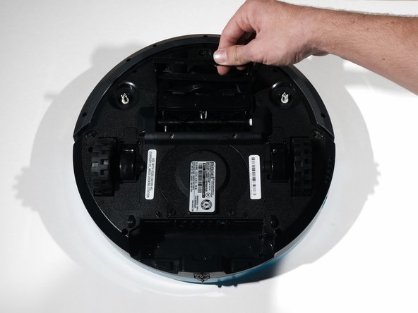

    • Make sure your device is powered off.
  2. Bissell SmartClean 1605 Roller Brush Replacement: crwdns2935265:02crwdnd2935265:01crwdnd2935265:01crwdne2935265:0
    • Gently flip device over.
  3. Bissell SmartClean 1605 Roller Brush Replacement: crwdns2935265:03crwdnd2935265:01crwdnd2935265:03crwdne2935265:0 Bissell SmartClean 1605 Roller Brush Replacement: crwdns2935265:03crwdnd2935265:02crwdnd2935265:03crwdne2935265:0 Bissell SmartClean 1605 Roller Brush Replacement: crwdns2935265:03crwdnd2935265:03crwdnd2935265:03crwdne2935265:0

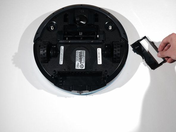

    • Remove plastic plate cover to reveal brush roller.

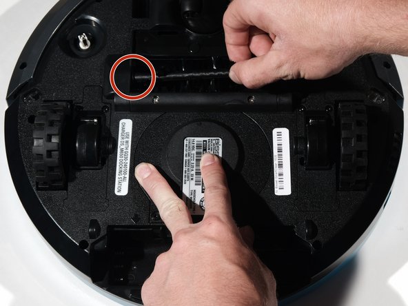

    • Remove brush roller from its slots on either side.
    • Apply pressure to one side and pull the roller out of its opposite slot.
    • It's like taking out a spring loaded toilet paper holder.

What if mine don't feel spring loaded and the brushe seems like it was just wants to fall out
Brian - crwdns2934203:0crwdne2934203:0
I'm having the same issue. The spring is not reloading to the brush just falls out
Rachel -
Same issue with mine. Took it apart and found that the side with spring loaded holder was broken.
Ryan Beaudre - crwdns2934203:0crwdne2934203:0
I am having the same issue it’s like a part is missing for the pin side not the square sides to hold the brush roll in place.
Geoffrey Fraser - crwdns2934203:0crwdne2934203:0
I have the same issue…it seems that the spring part was lost.have anyone of you find a replacement parts?
