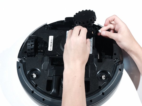

Bissell SmartClean 1605 Motor/Wheels Replacement
  1. Bissell SmartClean 1605 Motor/Wheels Replacement, Motor/Wheels: crwdns2935265:01crwdnd2935265:01crwdnd2935265:01crwdne2935265:0
    • Lay the Bissell 1605 on its back with the stickers on the end furthest from you.
  2. Bissell SmartClean 1605 Motor/Wheels Replacement: crwdns2935265:02crwdnd2935265:01crwdnd2935265:01crwdne2935265:0
    • Put one finger on the wheel and the other under the access cover.
  3. Bissell SmartClean 1605 Motor/Wheels Replacement: crwdns2935265:03crwdnd2935265:01crwdnd2935265:03crwdne2935265:0 Bissell SmartClean 1605 Motor/Wheels Replacement: crwdns2935265:03crwdnd2935265:02crwdnd2935265:03crwdne2935265:0 Bissell SmartClean 1605 Motor/Wheels Replacement: crwdns2935265:03crwdnd2935265:03crwdnd2935265:03crwdne2935265:0
    • Remove the spring and carefully pull the wires out to disconnect the wheel from the socket.
