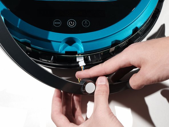

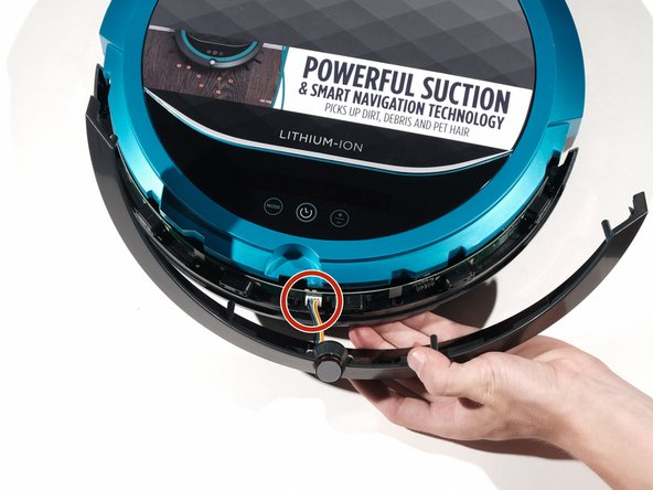

  3. Bissell SmartClean 1605 Front Cover Replacement: crwdns2935265:03crwdnd2935265:01crwdnd2935265:03crwdne2935265:0 Bissell SmartClean 1605 Front Cover Replacement: crwdns2935265:03crwdnd2935265:02crwdnd2935265:03crwdne2935265:0 Bissell SmartClean 1605 Front Cover Replacement: crwdns2935265:03crwdnd2935265:03crwdnd2935265:03crwdne2935265:0
    • Gently pry off the top half of the front cover
    • Remove the wires from the socket.
    • Don't pull the wires too hard, they can become disconnected from the plastic plug.

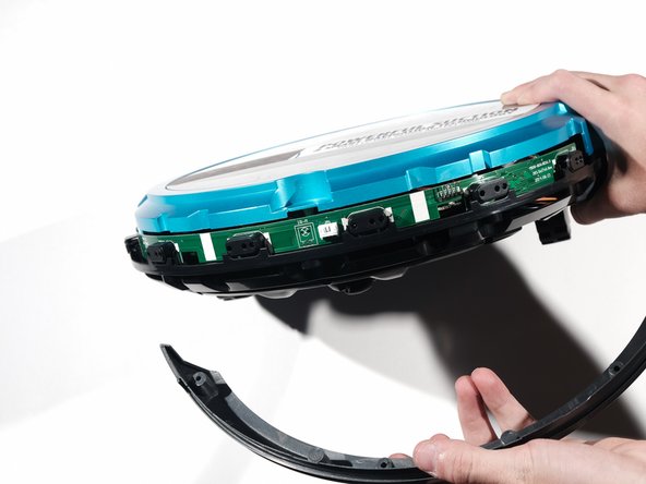

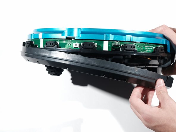

  4. Bissell SmartClean 1605 Front Cover Replacement: crwdns2935265:04crwdnd2935265:01crwdnd2935265:03crwdne2935265:0 Bissell SmartClean 1605 Front Cover Replacement: crwdns2935265:04crwdnd2935265:02crwdnd2935265:03crwdne2935265:0 Bissell SmartClean 1605 Front Cover Replacement: crwdns2935265:04crwdnd2935265:03crwdnd2935265:03crwdne2935265:0
    • Once the top cover is removed, pry off the bottom casing.
