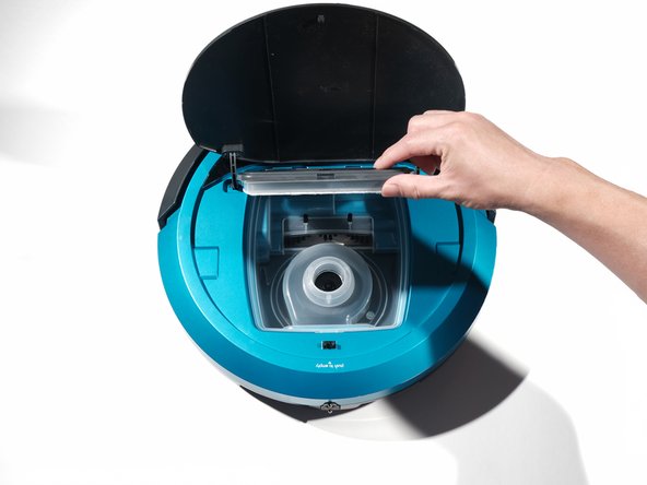

    • Position the SmartClean so that the Bissell logo is facing towards you backwards.
  2. Bissell SmartClean 1605 Filter Replacement: crwdns2935265:02crwdnd2935265:01crwdnd2935265:03crwdne2935265:0 Bissell SmartClean 1605 Filter Replacement: crwdns2935265:02crwdnd2935265:02crwdnd2935265:03crwdne2935265:0 Bissell SmartClean 1605 Filter Replacement: crwdns2935265:02crwdnd2935265:03crwdnd2935265:03crwdne2935265:0
    • Remember to press down till the cover clicks when reassembling.
    • Press down on the cover with the diamonds and lift up.

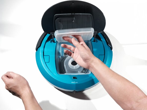

    • Flip the handle away from the cover.
    • Lift the handle up to open up the dust bin.

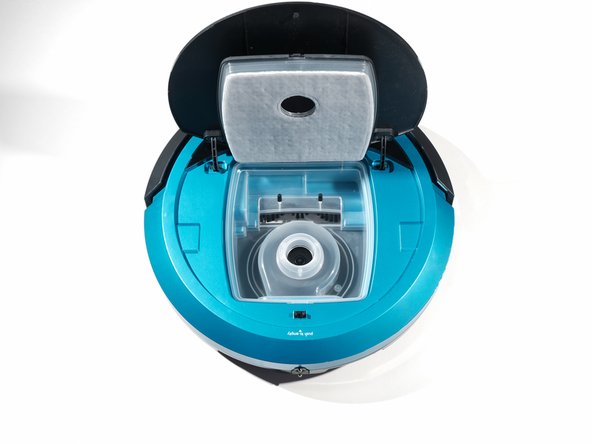

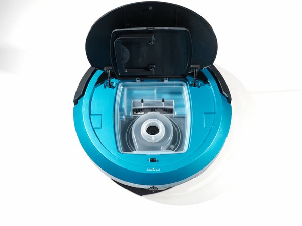

    • Use your finger to hook the filter through the opening near the center of the filter.
    • Gently yank the filter out with your fingers.
