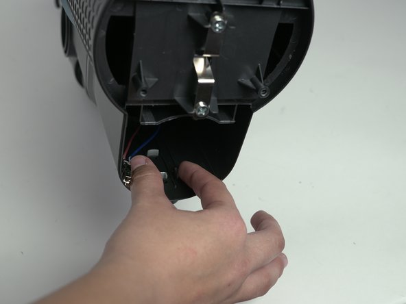

  4. Bissell Powerglide Cordless Release Button Replacement: crwdns2935265:04crwdnd2935265:01crwdnd2935265:01crwdne2935265:0
    • Remove the wire clips on both sides of the shaft.
  5. Bissell Powerglide Cordless Release Button Replacement: crwdns2935265:05crwdnd2935265:01crwdnd2935265:01crwdne2935265:0
    • Pull the top piece out of the shaft.

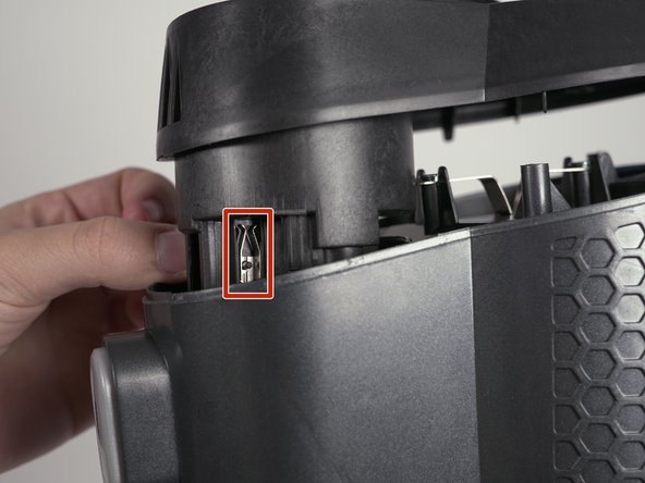

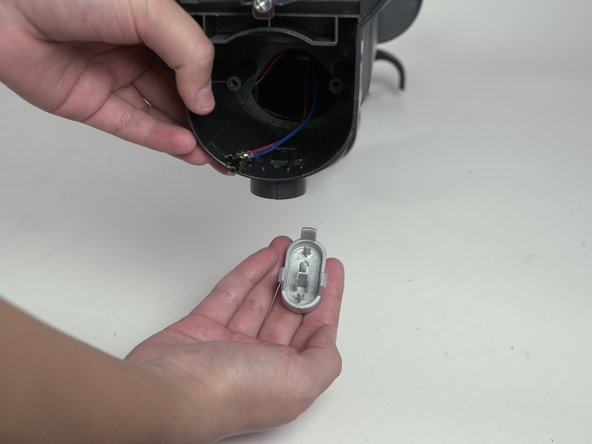

  6. Bissell Powerglide Cordless Release Button Replacement: crwdns2935265:06crwdnd2935265:01crwdnd2935265:03crwdne2935265:0 Bissell Powerglide Cordless Release Button Replacement: crwdns2935265:06crwdnd2935265:02crwdnd2935265:03crwdne2935265:0 Bissell Powerglide Cordless Release Button Replacement: crwdns2935265:06crwdnd2935265:03crwdnd2935265:03crwdne2935265:0
    • Pinch the two pairs of plastic catches (circled in the picture) to release the button.
