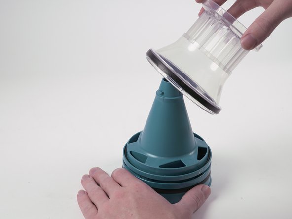

    • Remove the gray motor unit by twisting it so that the black triangle moves from the "locked" to the "unlocked" position.
  2. Bissell Powerglide Cordless Debris Canister Funnel Replacement: crwdns2935265:02crwdnd2935265:01crwdnd2935265:01crwdne2935265:0
    • Remove the filter from the dirt canister.
  3. Bissell Powerglide Cordless Debris Canister Funnel Replacement, Debris Canister Funnel: crwdns2935265:03crwdnd2935265:01crwdnd2935265:01crwdne2935265:0
    • Separate the cyclone assembly from the dirt tank by twisting the pieces counterclockwise.
  4. Bissell Powerglide Cordless Debris Canister Funnel Replacement: crwdns2935265:04crwdnd2935265:01crwdnd2935265:01crwdne2935265:0
    • Use a Phillips head screwdriver to remove the three screws from the bottom of the cyclone assembly.
    • Remove the bottom of the assembly.
  5. Bissell Powerglide Cordless Debris Canister Funnel Replacement: crwdns2935265:05crwdnd2935265:01crwdnd2935265:02crwdne2935265:0 Bissell Powerglide Cordless Debris Canister Funnel Replacement: crwdns2935265:05crwdnd2935265:02crwdnd2935265:02crwdne2935265:0
    • Twist the clear plastic capsule with the fins counterclockwise to remove it.
  6. Bissell Powerglide Cordless Debris Canister Funnel Replacement: crwdns2935265:06crwdnd2935265:01crwdnd2935265:01crwdne2935265:0
    • Twist the blue parts counterclockwise with a good amount of force to remove them.
