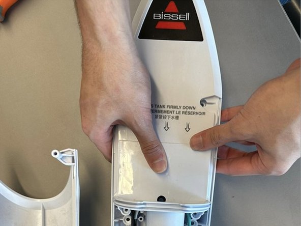

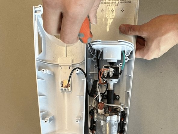

    • Turn the unit on its front so the bottom is facing up.
    • Remove the eight screws using a Phillips #2 screwdriver.
    • Remove the single screw holding the handle in place using a Phillips #2 screwdriver.
    • Pull the handle out.
  2. Bissell PowerFresh Steam Mop Power Cord Replacement: crwdns2935265:02crwdnd2935265:01crwdnd2935265:02crwdne2935265:0 Bissell PowerFresh Steam Mop Power Cord Replacement: crwdns2935265:02crwdnd2935265:02crwdnd2935265:02crwdne2935265:0
    • Remove the two screws from the underside of the mop where the mop head is connected using a Phillips #2 screwdriver.
    • Remove the mop head connector.
    • Remove two screws using a Phillips #2 screwdriver.
    • Pull the bottom portion of the front housing away from the rest of the mop.
  3. Bissell PowerFresh Steam Mop Power Cord Replacement: crwdns2935265:03crwdnd2935265:01crwdnd2935265:03crwdne2935265:0 Bissell PowerFresh Steam Mop Power Cord Replacement: crwdns2935265:03crwdnd2935265:02crwdnd2935265:03crwdne2935265:0 Bissell PowerFresh Steam Mop Power Cord Replacement: crwdns2935265:03crwdnd2935265:03crwdnd2935265:03crwdne2935265:0

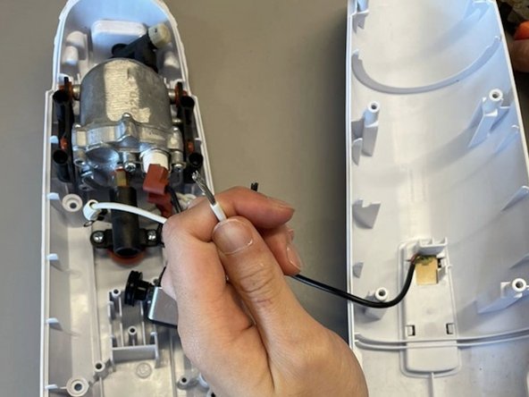

    • Remove two screws that are inside the unit using a Phillips #2 screwdriver.
    • Pull the top housing upwards to detach it from the water pump.
    • The main components pictured are the control circuit, the water pump and the heating unit.
  4. Bissell PowerFresh Steam Mop Power Cord Replacement: crwdns2935265:04crwdnd2935265:01crwdnd2935265:02crwdne2935265:0 Bissell PowerFresh Steam Mop Power Cord Replacement: crwdns2935265:04crwdnd2935265:02crwdnd2935265:02crwdne2935265:0

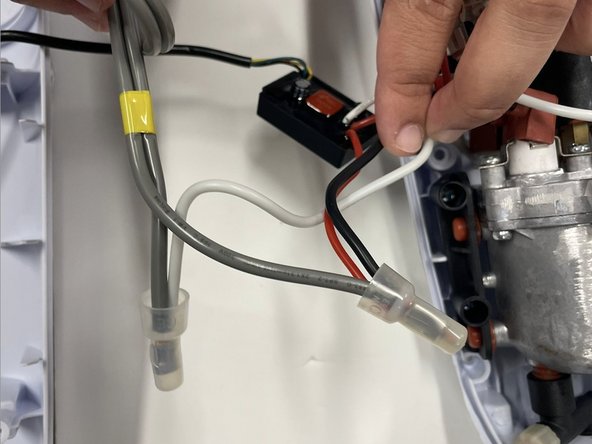

    • Remove the two screws from the plastic clamp using a Phillips #2 screwdriver.
    • Using a flush cutter or pliers, cut the original power cable and the white, black, and red wires as close to the plastic protective caps as possible.
    • Be careful not to disconnect the wires from the control circuit.
    • The damaged power cable can now be removed by pulling through from the back of the unit.
  5. Bissell PowerFresh Steam Mop Power Cord Replacement: crwdns2935265:05crwdnd2935265:01crwdnd2935265:03crwdne2935265:0 Bissell PowerFresh Steam Mop Power Cord Replacement: crwdns2935265:05crwdnd2935265:02crwdnd2935265:03crwdne2935265:0 Bissell PowerFresh Steam Mop Power Cord Replacement: crwdns2935265:05crwdnd2935265:03crwdnd2935265:03crwdne2935265:0

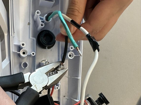

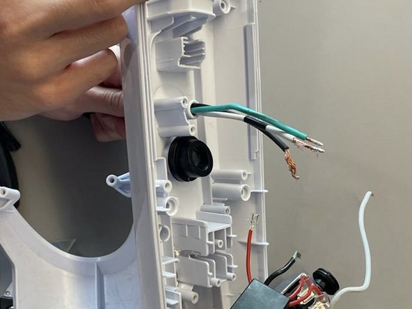

    • Plug in the soldering iron and allow it to heat up to approximately 350°C. For more soldering instructions, check out the How To Solder and Desolder Connections guide.
    • Prep the replacement cable and wires by using a wire stripper or pliers to remove approximately 0.5 inches of the plastic insulation.
    • Strip the hot and neutral wires belonging to the unit. In this model, the hot wires are black and red and the neutral wire is white.
    • Strip the wires belonging to the replacement cable.
    • Feed the replacement cable through the entry point at the back of the unit. If it does not fit, the rubber insulation can be stripped further using a utility knife.
  6. Bissell PowerFresh Steam Mop Power Cord Replacement: crwdns2935265:06crwdnd2935265:01crwdnd2935265:01crwdne2935265:0
    • Solder the neutral wire from the replacement cable to the white wire of the unit.
    • It may be helpful to have a second pair of hands to hold the wires steady while soldering.

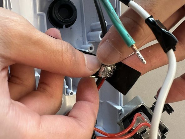

  7. Bissell PowerFresh Steam Mop Power Cord Replacement: crwdns2935265:07crwdnd2935265:01crwdnd2935265:03crwdne2935265:0 Bissell PowerFresh Steam Mop Power Cord Replacement: crwdns2935265:07crwdnd2935265:02crwdnd2935265:03crwdne2935265:0 Bissell PowerFresh Steam Mop Power Cord Replacement: crwdns2935265:07crwdnd2935265:03crwdnd2935265:03crwdne2935265:0
    • Solder the hot wire from the replacement cable to the black and red wires of the unit.
    • Pliers can be used to crimp solder around the wires in case it becomes loose.
    • Tape around soldered wires with electrical tape.
  8. Bissell PowerFresh Steam Mop Power Cord Replacement: crwdns2935265:08crwdnd2935265:01crwdnd2935265:03crwdne2935265:0 Bissell PowerFresh Steam Mop Power Cord Replacement: crwdns2935265:08crwdnd2935265:02crwdnd2935265:03crwdne2935265:0 Bissell PowerFresh Steam Mop Power Cord Replacement: crwdns2935265:08crwdnd2935265:03crwdnd2935265:03crwdne2935265:0
    • The power cable for this model does not utilize the ground wire (green). If the replacement cable contains a ground wire, tape around the exposed wire using electrical tape.
    • Shrink tubing can also be used to provide seamless reconnection and protection of the wires.
    • Secure modules of the unit back into the housing.
