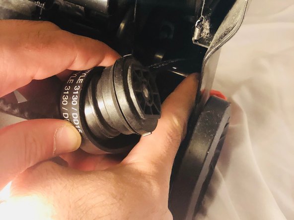

    • Remove the 5 screws from the brush plate with the phillips screwdriver.

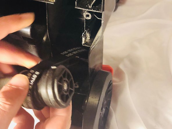

    • Lift off the brush plate by grabbing both ends of the plate and lifting the plate up.

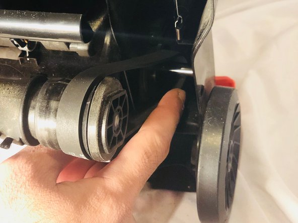

    • Grab the rotating brush at both ends.
    • Lift the rotating brush straight out of the vacuum.
    • Remove the belt from the motor pulley.

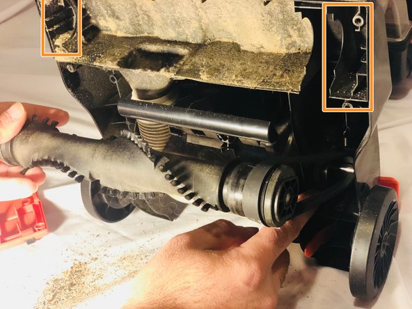

    • Clear the bottom of the vacuum from any debris that may be blocking air flow.
    • Clean the rotating brush from any wrapped string or hair. You can use scissors if needed.

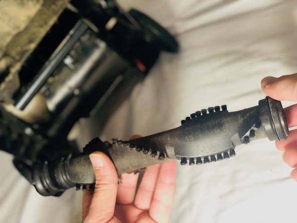

    • Check the new belt for any damage.
    • Place the belt on the rotating brush and then the motor pulley.
