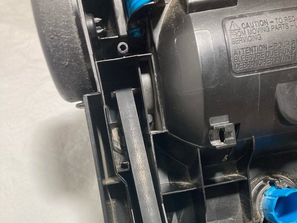

  4. Bissell Power Force Helix Vacuum Belt Replacement: crwdns2935265:04crwdnd2935265:01crwdnd2935265:01crwdne2935265:0
    • Locate the metal pin in the top left corner of the vacuum.

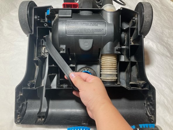

  5. Bissell Power Force Helix Vacuum Belt Replacement: crwdns2935265:05crwdnd2935265:01crwdnd2935265:03crwdne2935265:0 Bissell Power Force Helix Vacuum Belt Replacement: crwdns2935265:05crwdnd2935265:02crwdnd2935265:03crwdne2935265:0 Bissell Power Force Helix Vacuum Belt Replacement: crwdns2935265:05crwdnd2935265:03crwdnd2935265:03crwdne2935265:0
    • Loop the replacement belt around the metal pin.

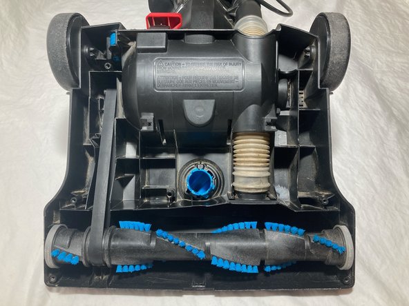

  6. Bissell Power Force Helix Vacuum Belt Replacement: crwdns2935265:06crwdnd2935265:01crwdnd2935265:01crwdne2935265:0
    • Hook the belt over the notch on the brush roller.

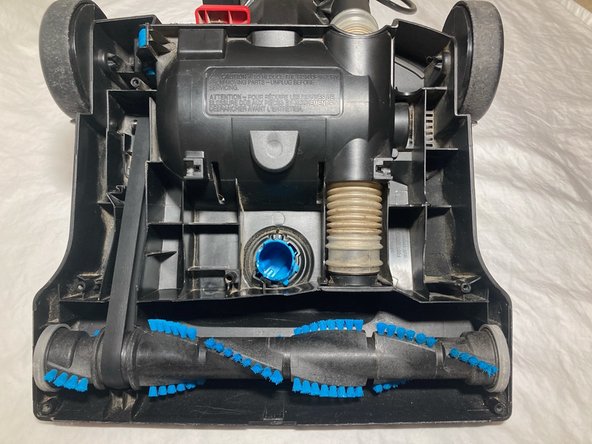

  7. Bissell Power Force Helix Vacuum Belt Replacement: crwdns2935265:07crwdnd2935265:01crwdnd2935265:02crwdne2935265:0 Bissell Power Force Helix Vacuum Belt Replacement: crwdns2935265:07crwdnd2935265:02crwdnd2935265:02crwdne2935265:0
    • Stretch the belt and brush roller towards the end of the vacuum.
    • Pop the brush roller back into place.
