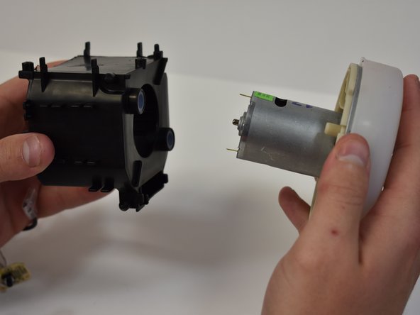

  8. Bissell Pet Hair Eraser Vacuum Motor Replacement: crwdns2935265:08crwdnd2935265:01crwdnd2935265:01crwdne2935265:0
    • Remove the two 1 mm Phillips #2 screws in the shown locations.
  9. Bissell Pet Hair Eraser Vacuum Motor Replacement: crwdns2935265:09crwdnd2935265:01crwdnd2935265:02crwdne2935265:0 Bissell Pet Hair Eraser Vacuum Motor Replacement: crwdns2935265:09crwdnd2935265:02crwdnd2935265:02crwdne2935265:0
    • Disconnect the power leads from the vacuum motor.
    • The red power lead goes on the terminal with the visible red dot.
  10. Bissell Pet Hair Eraser Vacuum Motor Replacement, Vacuum Motor: crwdns2935265:010crwdnd2935265:01crwdnd2935265:02crwdne2935265:0 Bissell Pet Hair Eraser Vacuum Motor Replacement, Vacuum Motor: crwdns2935265:010crwdnd2935265:02crwdnd2935265:02crwdne2935265:0
    • Grasp the vacuum motor and housing and pull them apart.
