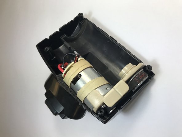

    • Remove the four 13.0 mm Phillips #0 screws and remove the green cover.
  5. Bissell Pet Hair Eraser Motorized Brush Belt Replacement: crwdns2935265:05crwdnd2935265:01crwdnd2935265:01crwdne2935265:0
    • Take out the motor assembly.

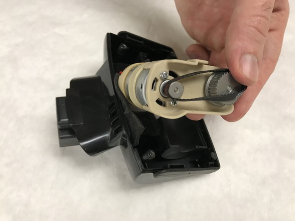

  6. Bissell Pet Hair Eraser Motorized Brush Belt Replacement, Motorized Brush Belt: crwdns2935265:06crwdnd2935265:01crwdnd2935265:01crwdne2935265:0
    • Take the belt off the gear by using a spudger.
  7. Bissell Pet Hair Eraser Motorized Brush Belt Replacement: crwdns2935265:07crwdnd2935265:01crwdnd2935265:03crwdne2935265:0 Bissell Pet Hair Eraser Motorized Brush Belt Replacement: crwdns2935265:07crwdnd2935265:02crwdnd2935265:03crwdne2935265:0 Bissell Pet Hair Eraser Motorized Brush Belt Replacement: crwdns2935265:07crwdnd2935265:03crwdnd2935265:03crwdne2935265:0
    • Grab the new belt and slide it on to the two gears.
    • Place the motor assembly back into the motorized brush enclosure.
To reassemble your device, follow the motorized brush disassembly instructions in reverse order.
