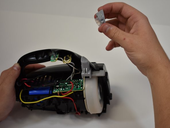

    • Remove the six 1.2 mm Philips #2 screws from the handle and base.

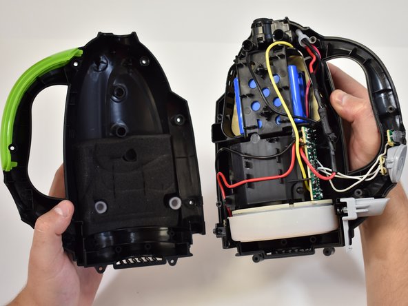

  3. Bissell Pet Hair Eraser Motherboard Replacement: crwdns2935265:03crwdnd2935265:01crwdnd2935265:02crwdne2935265:0 Bissell Pet Hair Eraser Motherboard Replacement: crwdns2935265:03crwdnd2935265:02crwdnd2935265:02crwdne2935265:0
    • Grasp each half of the body and gently pull apart.
    • The green handle, power button, charge light lens, and dirt cup release are not fastened in place.
    • Once the case is split apart these items may come dislodged.

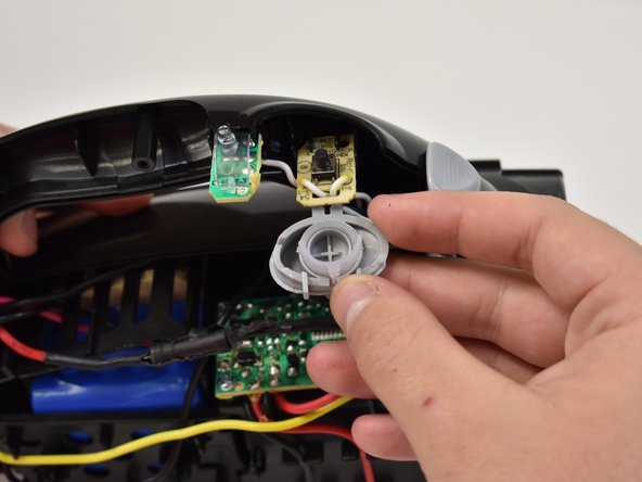

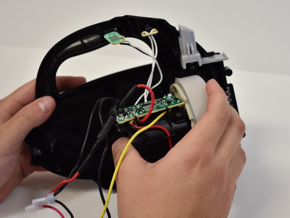

  4. Bissell Pet Hair Eraser Motherboard Replacement: crwdns2935265:04crwdnd2935265:01crwdnd2935265:03crwdne2935265:0 Bissell Pet Hair Eraser Motherboard Replacement: crwdns2935265:04crwdnd2935265:02crwdnd2935265:03crwdne2935265:0 Bissell Pet Hair Eraser Motherboard Replacement: crwdns2935265:04crwdnd2935265:03crwdnd2935265:03crwdne2935265:0
    • The power button can be removed by gently lifting it off the circuitry.

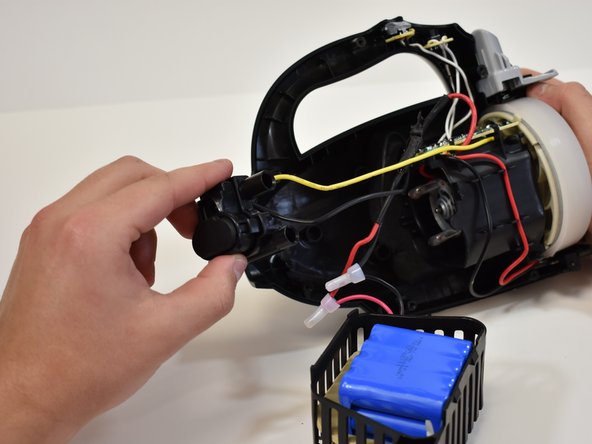

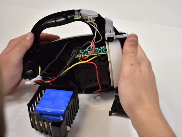

    • Remove the battery plastic hold down by lifting it off the tabs.
    • Remove the battery by lifting straight up.
    • Position the battery aside.

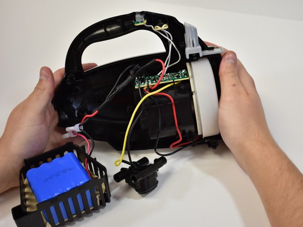

  6. Bissell Pet Hair Eraser Motherboard Replacement: crwdns2935265:06crwdnd2935265:01crwdnd2935265:03crwdne2935265:0 Bissell Pet Hair Eraser Motherboard Replacement: crwdns2935265:06crwdnd2935265:02crwdnd2935265:03crwdne2935265:0 Bissell Pet Hair Eraser Motherboard Replacement: crwdns2935265:06crwdnd2935265:03crwdnd2935265:03crwdne2935265:0
    • Grasp the charger port and remove it by lifting it straight out of the case.
    • Set the charger port next to the battery.

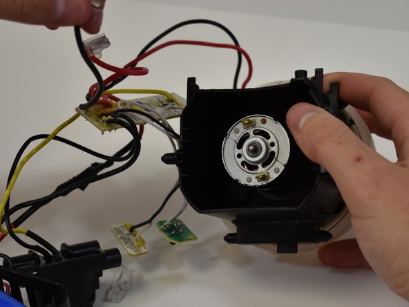

  7. Bissell Pet Hair Eraser Motherboard Replacement: crwdns2935265:07crwdnd2935265:01crwdnd2935265:02crwdne2935265:0 Bissell Pet Hair Eraser Motherboard Replacement: crwdns2935265:07crwdnd2935265:02crwdnd2935265:02crwdne2935265:0
    • Remove the power button and charge LED light by gently pulling straight out of the case.
    • The vacuum motor can be removed by pulling straight out of the case.
    • All internals are now removed.
    • Set the case halves aside.
