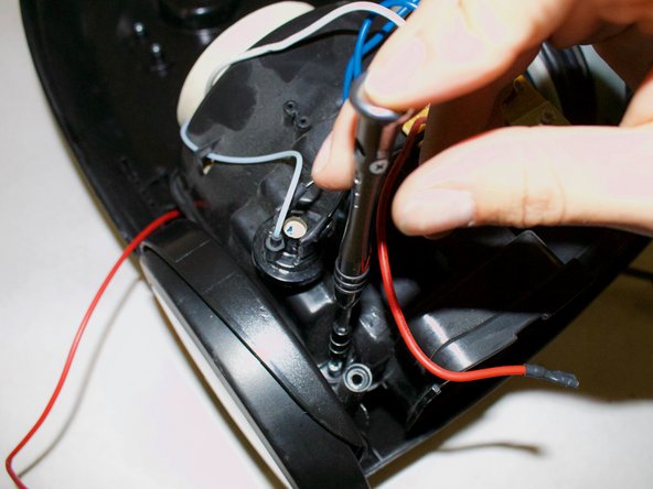

    • Unscrew both screws near the wheels.

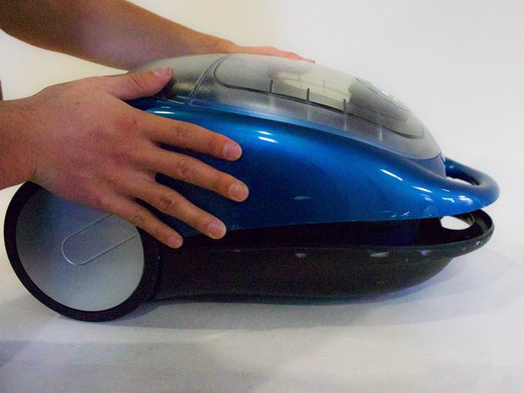

  13. Bissell OptiClean Cyclonic Vacuum Motor and Circuit Board Replacement: crwdns2935265:013crwdnd2935265:01crwdnd2935265:03crwdne2935265:0 Bissell OptiClean Cyclonic Vacuum Motor and Circuit Board Replacement: crwdns2935265:013crwdnd2935265:02crwdnd2935265:03crwdne2935265:0 Bissell OptiClean Cyclonic Vacuum Motor and Circuit Board Replacement: crwdns2935265:013crwdnd2935265:03crwdnd2935265:03crwdne2935265:0

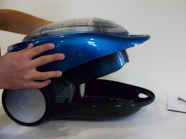

    • Flip over vacuum.
    • Gently lift off top.
    • Do not try to take off completely. There are still wires attached to the hull.

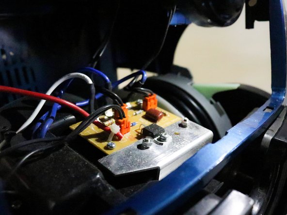

    • Locate the circuit board.
  15. Bissell OptiClean Cyclonic Vacuum Motor and Circuit Board Replacement: crwdns2935265:015crwdnd2935265:01crwdnd2935265:03crwdne2935265:0 Bissell OptiClean Cyclonic Vacuum Motor and Circuit Board Replacement: crwdns2935265:015crwdnd2935265:02crwdnd2935265:03crwdne2935265:0 Bissell OptiClean Cyclonic Vacuum Motor and Circuit Board Replacement: crwdns2935265:015crwdnd2935265:03crwdnd2935265:03crwdne2935265:0

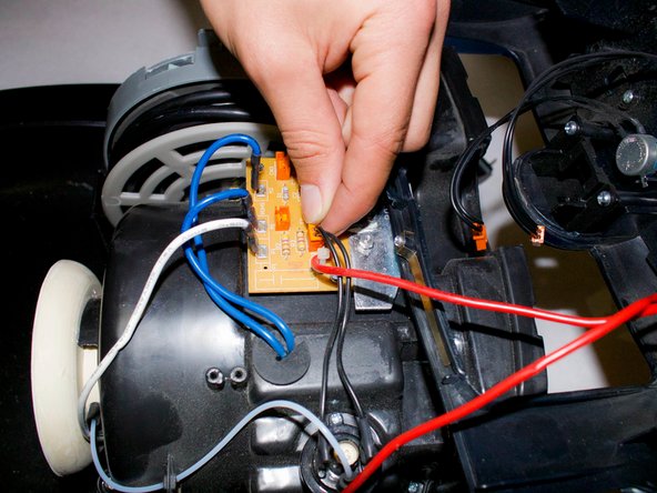

    • Unplug each orange plug.
    • Make sure you remember which orange plug goes where!

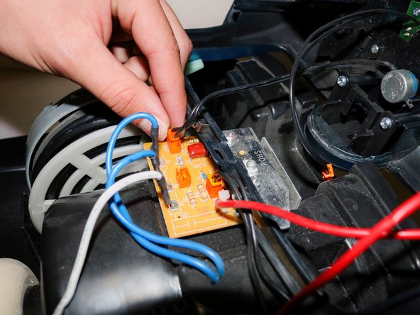

  16. Bissell OptiClean Cyclonic Vacuum Motor and Circuit Board Replacement: crwdns2935265:016crwdnd2935265:01crwdnd2935265:02crwdne2935265:0 Bissell OptiClean Cyclonic Vacuum Motor and Circuit Board Replacement: crwdns2935265:016crwdnd2935265:02crwdnd2935265:02crwdne2935265:0
    • Unplug the red wires. The wires may be a little difficult to take off. If they are, you may use a pair of pliers to pull the wires off.
    • Make sure not to wiggle the wires, as that may break the metal holding them.

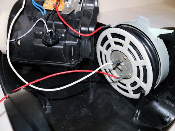

    • Lift motor and move it over the gain access to the spool.
    • Unscrew the screw on the spool.
    • Remove the plastic circle.
