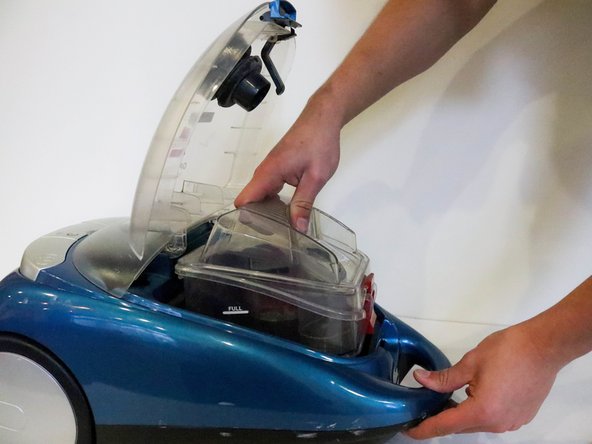

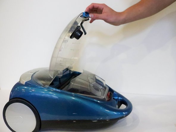

      • After removing hose, place vacuum on back and unclip the top compartment.
      • Open the compartment.
      • Pull the dirt collection box out of the vacuum.

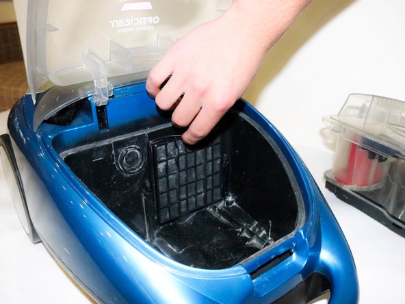

    2. Bissell OptiClean Cyclonic Vacuum Filter Replacements: crwdns2935265:05crwdnd2935265:01crwdnd2935265:03crwdne2935265:0 Bissell OptiClean Cyclonic Vacuum Filter Replacements: crwdns2935265:05crwdnd2935265:02crwdnd2935265:03crwdne2935265:0 Bissell OptiClean Cyclonic Vacuum Filter Replacements: crwdns2935265:05crwdnd2935265:03crwdnd2935265:03crwdne2935265:0
      • Place dirt collection box to the side.
      • Locate the Pre-Motor Filter.
      • Pull the filter out by grabbing the pull tab on top.

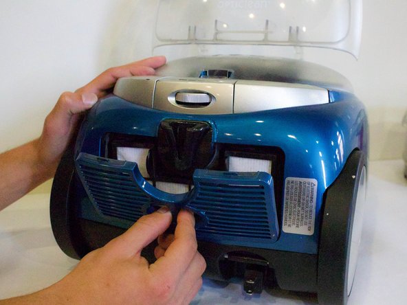

      • Turn vacuum around and locate the filter cover on the bottom.
      • Place fingers in the opening and pull off the filter cover.
      • Place fingers on each tab on the Post-Motor HEPA Media Filter and pull out.

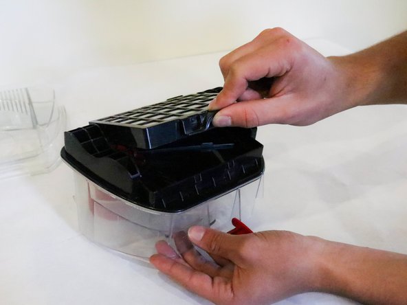

      • To clean Dirt Collection Box, unlatch lid and take off.
    5. Bissell OptiClean Cyclonic Vacuum Filter Replacements: crwdns2935265:08crwdnd2935265:01crwdnd2935265:03crwdne2935265:0 Bissell OptiClean Cyclonic Vacuum Filter Replacements: crwdns2935265:08crwdnd2935265:02crwdnd2935265:03crwdne2935265:0 Bissell OptiClean Cyclonic Vacuum Filter Replacements: crwdns2935265:08crwdnd2935265:03crwdnd2935265:03crwdne2935265:0
      • Flip Dirt Collection Box over and locate the push tab.
      • Push the Dirt Cup HEPA Media Filter up to take it off.
