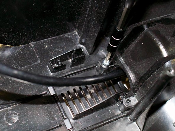

  24. Bissell OptiClean Cyclonic Vacuum Cord w/ Reel Replacement: crwdns2935265:024crwdnd2935265:01crwdnd2935265:02crwdne2935265:0 Bissell OptiClean Cyclonic Vacuum Cord w/ Reel Replacement: crwdns2935265:024crwdnd2935265:02crwdnd2935265:02crwdne2935265:0
    • Use screwdriver to remove screws from either side of the cord.
  25. Bissell OptiClean Cyclonic Vacuum Cord w/ Reel Replacement: crwdns2935265:025crwdnd2935265:01crwdnd2935265:02crwdne2935265:0 Bissell OptiClean Cyclonic Vacuum Cord w/ Reel Replacement: crwdns2935265:025crwdnd2935265:02crwdnd2935265:02crwdne2935265:0

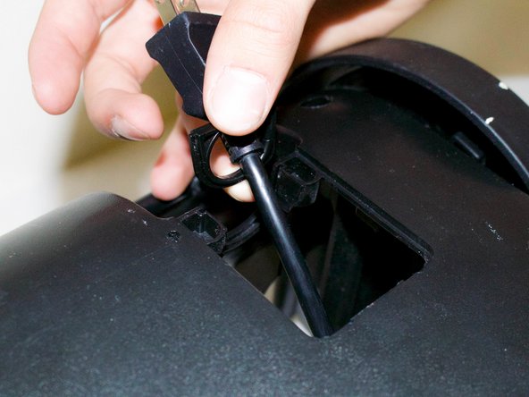

    • Flip over vacuum.
    • Remove grate that holds the power cord as pictured.
  26. Bissell OptiClean Cyclonic Vacuum Cord w/ Reel Replacement: crwdns2935265:026crwdnd2935265:01crwdnd2935265:02crwdne2935265:0 Bissell OptiClean Cyclonic Vacuum Cord w/ Reel Replacement: crwdns2935265:026crwdnd2935265:02crwdnd2935265:02crwdne2935265:0
    • Grab hold of head of power cord and pull up.
    • Power cord should disconnect from vacuum body as pictured.
