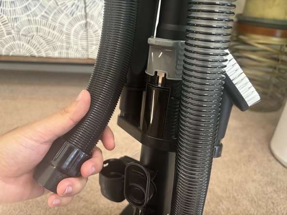

  1. Bissell Cleanview Compact Turbo 3437F Hose Replacement, Hose: crwdns2935265:01crwdnd2935265:01crwdnd2935265:03crwdne2935265:0 Bissell Cleanview Compact Turbo 3437F Hose Replacement, Hose: crwdns2935265:01crwdnd2935265:02crwdnd2935265:03crwdne2935265:0 Bissell Cleanview Compact Turbo 3437F Hose Replacement, Hose: crwdns2935265:01crwdnd2935265:03crwdnd2935265:03crwdne2935265:0
    • Twist the head of the hose in order to undo the part's lock and pull up to disconnect it.

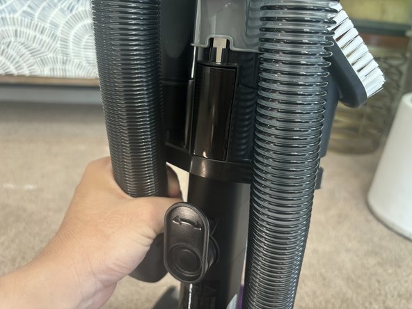

  2. Bissell Cleanview Compact Turbo 3437F Hose Replacement: crwdns2935265:02crwdnd2935265:01crwdnd2935265:02crwdne2935265:0 Bissell Cleanview Compact Turbo 3437F Hose Replacement: crwdns2935265:02crwdnd2935265:02crwdnd2935265:02crwdne2935265:0
    • Disconnect the hose from the securing piece on the handle.

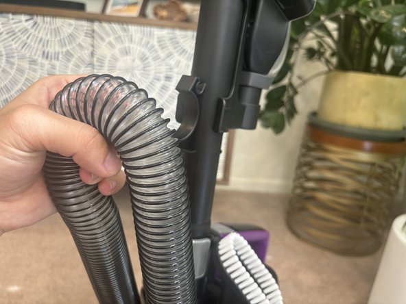

  3. Bissell Cleanview Compact Turbo 3437F Hose Replacement: crwdns2935265:03crwdnd2935265:01crwdnd2935265:02crwdne2935265:0 Bissell Cleanview Compact Turbo 3437F Hose Replacement: crwdns2935265:03crwdnd2935265:02crwdnd2935265:02crwdne2935265:0
    • Pull up on the other head of the hose to remove it from the vacuum.
