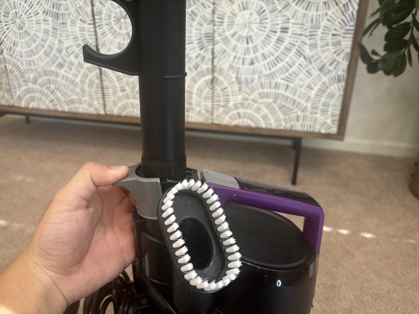

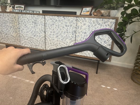

Bissell Cleanview Compact Turbo 3437F Handle Replacement
  1. Bissell Cleanview Compact Turbo 3437F Handle Replacement, Handle: crwdns2935265:01crwdnd2935265:01crwdnd2935265:03crwdne2935265:0 Bissell Cleanview Compact Turbo 3437F Handle Replacement, Handle: crwdns2935265:01crwdnd2935265:02crwdnd2935265:03crwdne2935265:0 Bissell Cleanview Compact Turbo 3437F Handle Replacement, Handle: crwdns2935265:01crwdnd2935265:03crwdnd2935265:03crwdne2935265:0
    • Detach the hose and alternate vacuum head attachments from the handle.
  2. Bissell Cleanview Compact Turbo 3437F Handle Replacement: crwdns2935265:02crwdnd2935265:01crwdnd2935265:03crwdne2935265:0 Bissell Cleanview Compact Turbo 3437F Handle Replacement: crwdns2935265:02crwdnd2935265:02crwdnd2935265:03crwdne2935265:0 Bissell Cleanview Compact Turbo 3437F Handle Replacement: crwdns2935265:02crwdnd2935265:03crwdnd2935265:03crwdne2935265:0
    • Press down on the handle's release tab and pull the handle up to release it.
