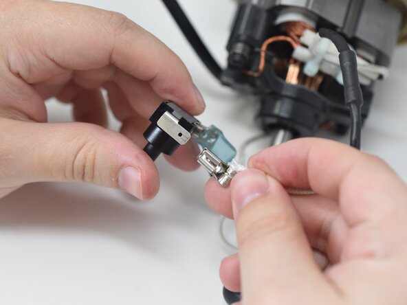

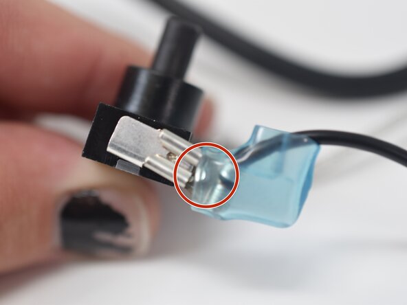

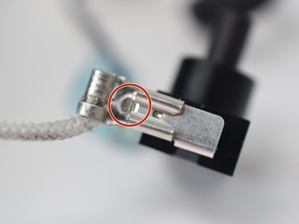

  14. Bissell CleanView Compact 3508 Power Switch Replacement, Power Switch: crwdns2935265:014crwdnd2935265:01crwdnd2935265:03crwdne2935265:0 Bissell CleanView Compact 3508 Power Switch Replacement, Power Switch: crwdns2935265:014crwdnd2935265:02crwdnd2935265:03crwdne2935265:0 Bissell CleanView Compact 3508 Power Switch Replacement, Power Switch: crwdns2935265:014crwdnd2935265:03crwdnd2935265:03crwdne2935265:0

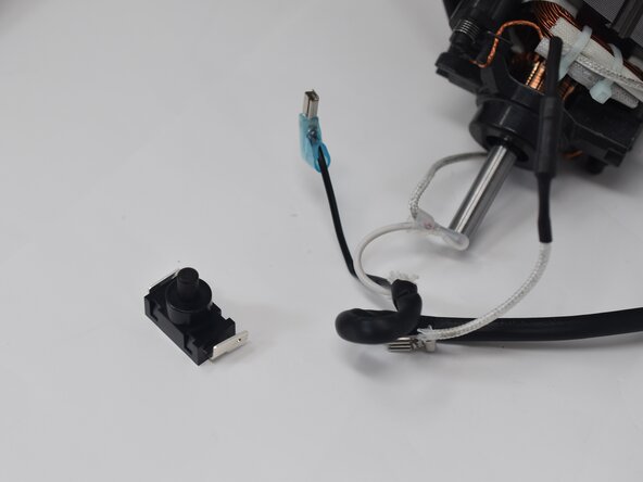

    • Identify the two wire connection points.
  15. Bissell CleanView Compact 3508 Power Switch Replacement: crwdns2935265:015crwdnd2935265:01crwdnd2935265:03crwdne2935265:0 Bissell CleanView Compact 3508 Power Switch Replacement: crwdns2935265:015crwdnd2935265:02crwdnd2935265:03crwdne2935265:0 Bissell CleanView Compact 3508 Power Switch Replacement: crwdns2935265:015crwdnd2935265:03crwdnd2935265:03crwdne2935265:0
    • Press down on the connection points and slide them out.
    • When both points are separated, you should have 3 pieces: the power cable, the switch, and the motor.
