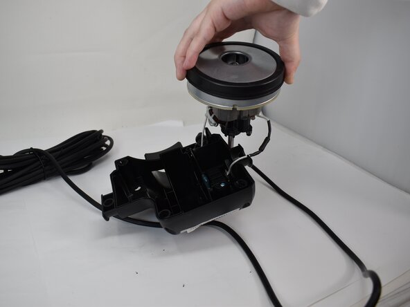

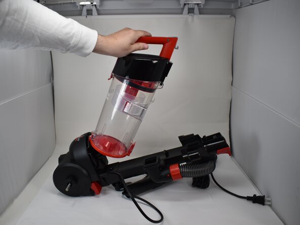

  8. Bissell CleanView Compact 3508 Motor/Power Supply Replacement, Motor: crwdns2935265:08crwdnd2935265:01crwdnd2935265:02crwdne2935265:0 Bissell CleanView Compact 3508 Motor/Power Supply Replacement, Motor: crwdns2935265:08crwdnd2935265:02crwdnd2935265:02crwdne2935265:0
    • Push the button on the canister to remove it from the spine.
    • Set the canister to the side.

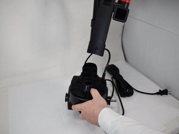

  9. Bissell CleanView Compact 3508 Motor/Power Supply Replacement: crwdns2935265:09crwdnd2935265:01crwdnd2935265:03crwdne2935265:0 Bissell CleanView Compact 3508 Motor/Power Supply Replacement: crwdns2935265:09crwdnd2935265:02crwdnd2935265:03crwdne2935265:0 Bissell CleanView Compact 3508 Motor/Power Supply Replacement: crwdns2935265:09crwdnd2935265:03crwdnd2935265:03crwdne2935265:0
    • Remove the one 20.7 mm screw with a Phillips #2 screwdriver.

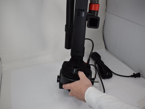

    • Separate the spine from the motor.

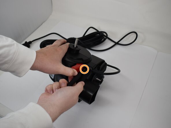

  10. Bissell CleanView Compact 3508 Motor/Power Supply Replacement: crwdns2935265:010crwdnd2935265:01crwdnd2935265:02crwdne2935265:0 Bissell CleanView Compact 3508 Motor/Power Supply Replacement: crwdns2935265:010crwdnd2935265:02crwdnd2935265:02crwdne2935265:0
    • Remove the four 2.7 mm screws with a Phillips #2 screwdriver.
    • Press down on the red lever to access another 20.7mm screw. Remove the screw with a Phillips #2 screwdriver.
  11. Bissell CleanView Compact 3508 Motor/Power Supply Replacement: crwdns2935265:011crwdnd2935265:01crwdnd2935265:03crwdne2935265:0 Bissell CleanView Compact 3508 Motor/Power Supply Replacement: crwdns2935265:011crwdnd2935265:02crwdnd2935265:03crwdne2935265:0 Bissell CleanView Compact 3508 Motor/Power Supply Replacement: crwdns2935265:011crwdnd2935265:03crwdnd2935265:03crwdne2935265:0
    • Separate the halves.
    • Take care not to strain the connected cables.

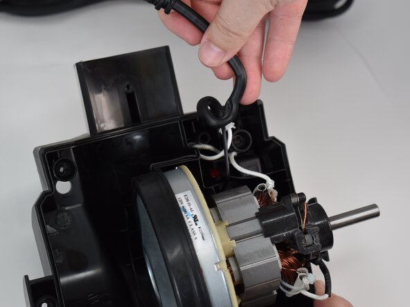

    • Unwind the power cable from its post, and gently pull the motor out of the casing.

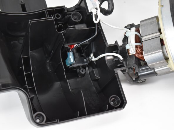

  12. Bissell CleanView Compact 3508 Motor/Power Supply Replacement: crwdns2935265:012crwdnd2935265:01crwdnd2935265:03crwdne2935265:0 Bissell CleanView Compact 3508 Motor/Power Supply Replacement: crwdns2935265:012crwdnd2935265:02crwdnd2935265:03crwdne2935265:0 Bissell CleanView Compact 3508 Motor/Power Supply Replacement: crwdns2935265:012crwdnd2935265:03crwdnd2935265:03crwdne2935265:0
    • By taking the motor out of its casing, the cover of the switch becomes exposed.
    • Use a Phillips #2 screwdriver to remove the 20.7 mm screw from the cover.
    • Gently remove the cover.

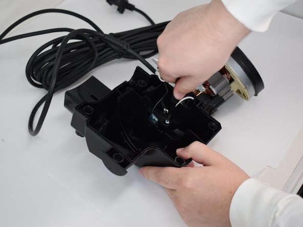

  13. Bissell CleanView Compact 3508 Motor/Power Supply Replacement: crwdns2935265:013crwdnd2935265:01crwdnd2935265:02crwdne2935265:0 Bissell CleanView Compact 3508 Motor/Power Supply Replacement: crwdns2935265:013crwdnd2935265:02crwdnd2935265:02crwdne2935265:0

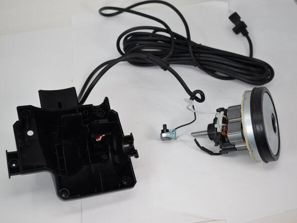

    • Gently disconnect the motor from the connector.
    • Remove the motor.
