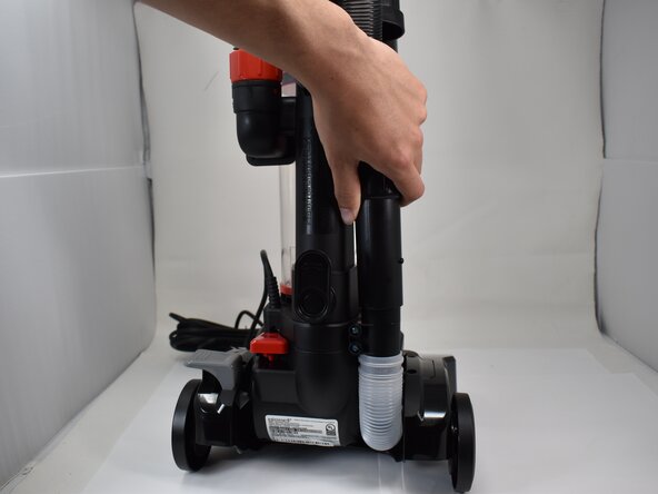

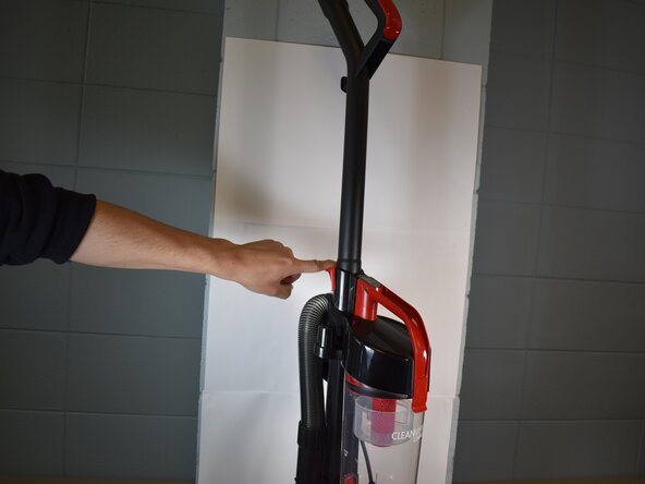

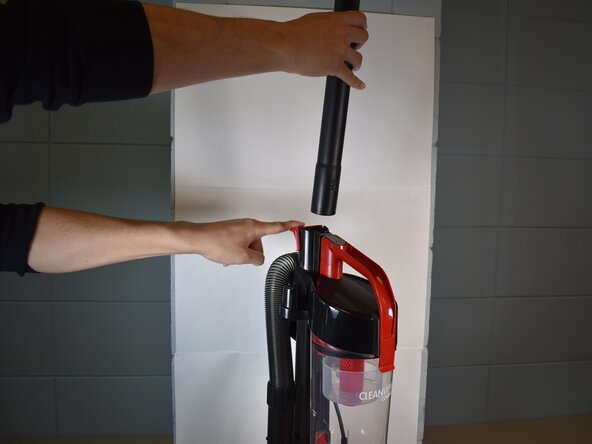

    • With the vacuum in an upright position, press the latch on the rear of the spine to remove the handle from the vacuum.

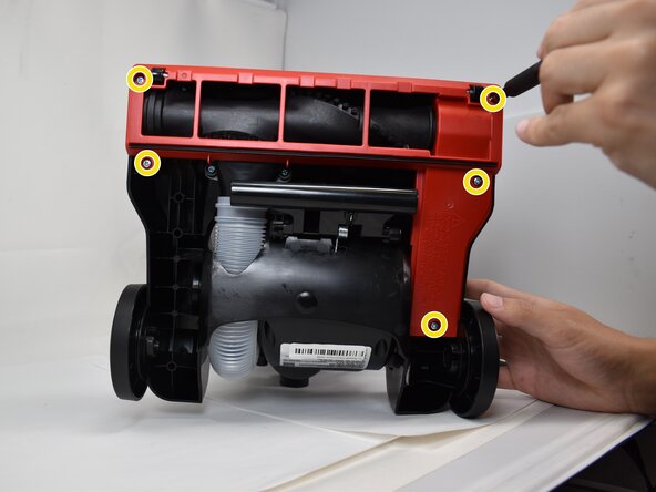

    • Use a Phillips #2 screwdriver to remove the five 20.7 mm screws on the underside of the brush roll cover.
  3. Bissell CleanView Compact 3508 Lower Hose Replacement: crwdns2935265:03crwdnd2935265:01crwdnd2935265:03crwdne2935265:0 Bissell CleanView Compact 3508 Lower Hose Replacement: crwdns2935265:03crwdnd2935265:02crwdnd2935265:03crwdne2935265:0 Bissell CleanView Compact 3508 Lower Hose Replacement: crwdns2935265:03crwdnd2935265:03crwdnd2935265:03crwdne2935265:0
    • Use a pry tool or flathead screwdriver to disengage the two retaining clips securing the brush roll cover.
    • Remove the brush roll cover.

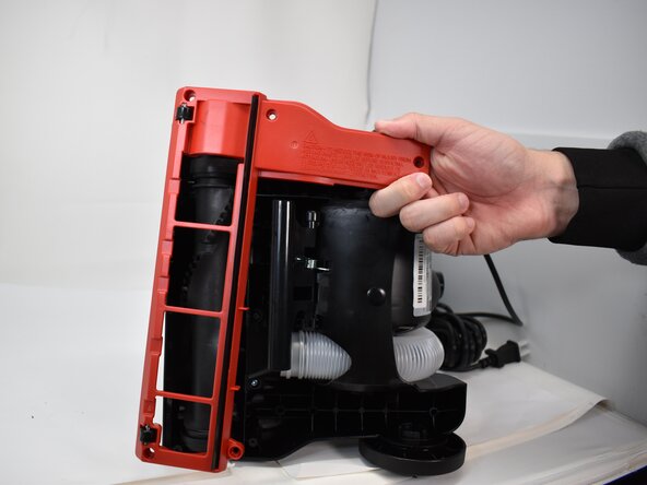

  4. Bissell CleanView Compact 3508 Lower Hose Replacement, Top/Bottom: crwdns2935265:04crwdnd2935265:01crwdnd2935265:03crwdne2935265:0 Bissell CleanView Compact 3508 Lower Hose Replacement, Top/Bottom: crwdns2935265:04crwdnd2935265:02crwdnd2935265:03crwdne2935265:0 Bissell CleanView Compact 3508 Lower Hose Replacement, Top/Bottom: crwdns2935265:04crwdnd2935265:03crwdnd2935265:03crwdne2935265:0

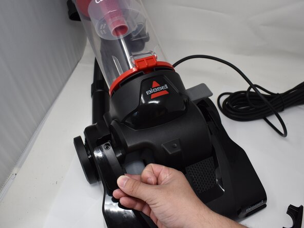

    • Disconnect the main black hose from its lower attachment point.

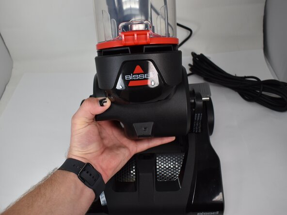

    • Use a Phillips #2 screwdriver to remove the two 20.7 mm screws from the lower hose attachment point.

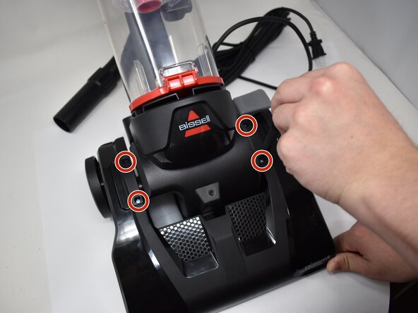

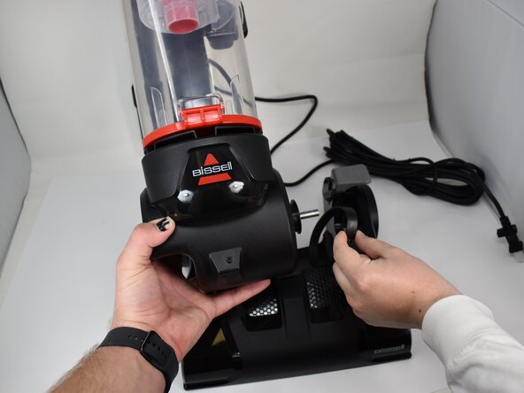

    • Use a Phillips #2 screwdriver to remove the four 20.7 mm screws on the upper cover plates.
    • Remove the two upper cover plates.

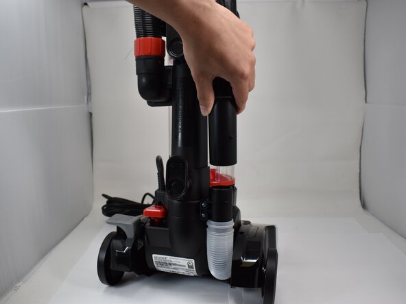

  7. Bissell CleanView Compact 3508 Lower Hose Replacement: crwdns2935265:07crwdnd2935265:01crwdnd2935265:03crwdne2935265:0 Bissell CleanView Compact 3508 Lower Hose Replacement: crwdns2935265:07crwdnd2935265:02crwdnd2935265:03crwdne2935265:0 Bissell CleanView Compact 3508 Lower Hose Replacement: crwdns2935265:07crwdnd2935265:03crwdnd2935265:03crwdne2935265:0
    • Gently pull the top half up and to the side away from the drive shaft to separate both halves.
    • Pull the belt through the socket, and remove the belt from the drive shaft.

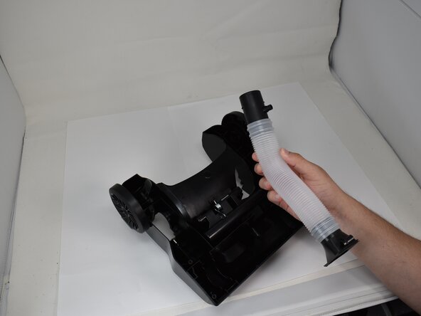

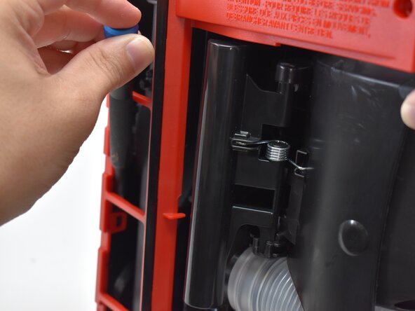

  8. Bissell CleanView Compact 3508 Lower Hose Replacement, Lower Hose: crwdns2935265:08crwdnd2935265:01crwdnd2935265:02crwdne2935265:0 Bissell CleanView Compact 3508 Lower Hose Replacement, Lower Hose: crwdns2935265:08crwdnd2935265:02crwdnd2935265:02crwdne2935265:0

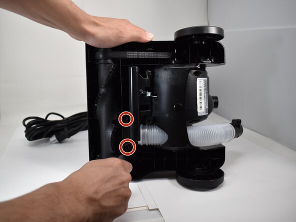

    • Flip the bottom upside to expose the bottom.

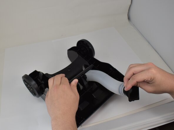

    • Pull back the lever back, and remove the two 20.7 mm screws from the hose.
  9. Bissell CleanView Compact 3508 Lower Hose Replacement: crwdns2935265:09crwdnd2935265:01crwdnd2935265:03crwdne2935265:0 Bissell CleanView Compact 3508 Lower Hose Replacement: crwdns2935265:09crwdnd2935265:02crwdnd2935265:03crwdne2935265:0 Bissell CleanView Compact 3508 Lower Hose Replacement: crwdns2935265:09crwdnd2935265:03crwdnd2935265:03crwdne2935265:0
    • Continue to hold the lever back and pull the hose through, with the outside side of the hose being pulled through the base.
