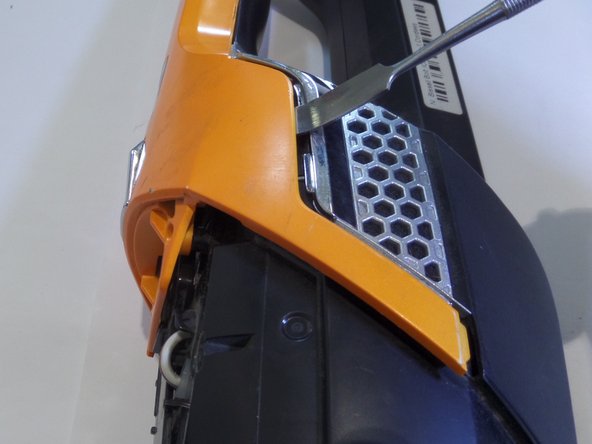

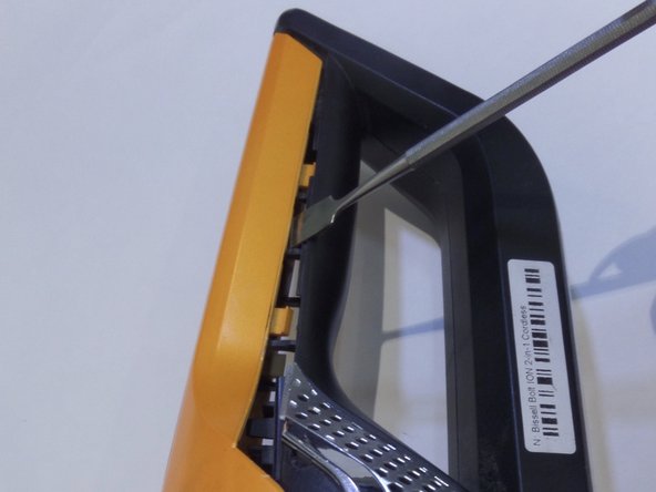

  3. Bissell Bolt ION 2-in-1 Cordless Release Button  Replacement: crwdns2935265:03crwdnd2935265:01crwdnd2935265:03crwdne2935265:0 Bissell Bolt ION 2-in-1 Cordless Release Button  Replacement: crwdns2935265:03crwdnd2935265:02crwdnd2935265:03crwdne2935265:0 Bissell Bolt ION 2-in-1 Cordless Release Button  Replacement: crwdns2935265:03crwdnd2935265:03crwdnd2935265:03crwdne2935265:0
    • Using the metal spudger, insert and lift up to remove the frame from the body.
    • Move along the line and repeat on the other side.

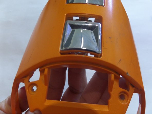

  4. Bissell Bolt ION 2-in-1 Cordless Release Button  Replacement: crwdns2935265:04crwdnd2935265:01crwdnd2935265:02crwdne2935265:0 Bissell Bolt ION 2-in-1 Cordless Release Button  Replacement: crwdns2935265:04crwdnd2935265:02crwdnd2935265:02crwdne2935265:0
    • When placing new button in make sure the bottom end goes in first.
