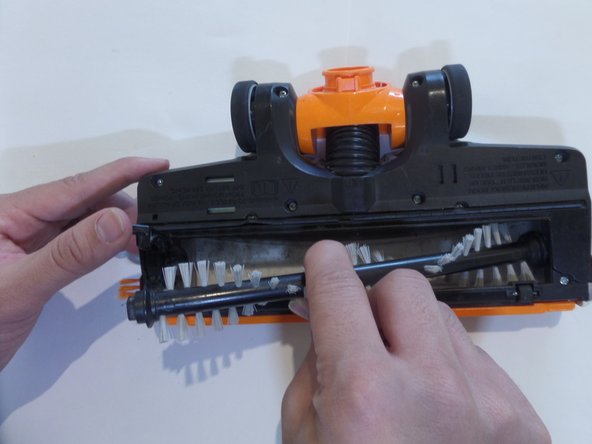

    • Push the release button on the back side of the device near the swivel head, to detach the swivel for convenient access to the brush roll.
  2. Bissell Bolt ION 2-in-1 Cordless Brush Replacement: crwdns2935265:02crwdnd2935265:01crwdnd2935265:03crwdne2935265:0 Bissell Bolt ION 2-in-1 Cordless Brush Replacement: crwdns2935265:02crwdnd2935265:02crwdnd2935265:03crwdne2935265:0 Bissell Bolt ION 2-in-1 Cordless Brush Replacement: crwdns2935265:02crwdnd2935265:03crwdnd2935265:03crwdne2935265:0
    • The guard notch will automatically be down in the locked position.
    • Slide the guard notch to the unlocked position.
  3. Bissell Bolt ION 2-in-1 Cordless Brush Replacement: crwdns2935265:03crwdnd2935265:01crwdnd2935265:02crwdne2935265:0 Bissell Bolt ION 2-in-1 Cordless Brush Replacement: crwdns2935265:03crwdnd2935265:02crwdnd2935265:02crwdne2935265:0
    • Lift up the latch to the right of the guard notch to access the brush.
    • While holding up the latch remove the brush.
    • Hold up latch to place new brush roll back into place.
