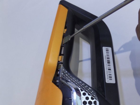

  2. Bissell Bolt ION 2-in-1 Cordless Battery Replacement: crwdns2935265:02crwdnd2935265:01crwdnd2935265:02crwdne2935265:0 Bissell Bolt ION 2-in-1 Cordless Battery Replacement: crwdns2935265:02crwdnd2935265:02crwdnd2935265:02crwdne2935265:0
    • Remove the four 4 .4cm screws using your P0 screwdriver head and screwdriver.
    • Remove the Bissell sign to remove the two 4.4cm screws, using your P0 screwdriver head and screwdriver.

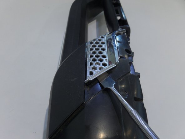

  3. Bissell Bolt ION 2-in-1 Cordless Battery Replacement: crwdns2935265:03crwdnd2935265:01crwdnd2935265:03crwdne2935265:0 Bissell Bolt ION 2-in-1 Cordless Battery Replacement: crwdns2935265:03crwdnd2935265:02crwdnd2935265:03crwdne2935265:0 Bissell Bolt ION 2-in-1 Cordless Battery Replacement: crwdns2935265:03crwdnd2935265:03crwdnd2935265:03crwdne2935265:0
    • Using the metal spudger, insert and lift up to remove the frame from the body.
    • Move along the line and repeat on the other side.

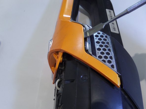

  4. Bissell Bolt ION 2-in-1 Cordless Battery Replacement: crwdns2935265:04crwdnd2935265:01crwdnd2935265:02crwdne2935265:0 Bissell Bolt ION 2-in-1 Cordless Battery Replacement: crwdns2935265:04crwdnd2935265:02crwdnd2935265:02crwdne2935265:0

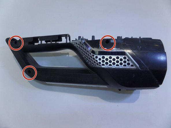

    • Remove the orange frame
    • Remove the 3 screws on the right side of the vacuum.

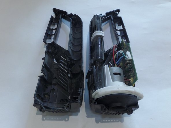

  5. Bissell Bolt ION 2-in-1 Cordless Battery Replacement: crwdns2935265:05crwdnd2935265:01crwdnd2935265:03crwdne2935265:0 Bissell Bolt ION 2-in-1 Cordless Battery Replacement: crwdns2935265:05crwdnd2935265:02crwdnd2935265:03crwdne2935265:0 Bissell Bolt ION 2-in-1 Cordless Battery Replacement: crwdns2935265:05crwdnd2935265:03crwdnd2935265:03crwdne2935265:0
    • With metal spudger remove the metal clip on both sides.
    • Pull device apart using great force
