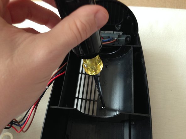

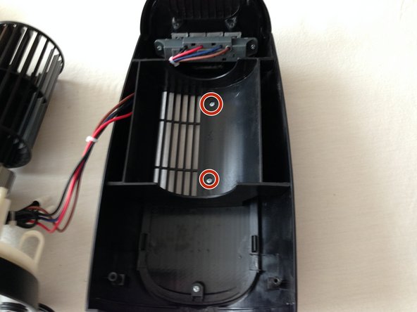

      • Once you have the fan apart, in order to get more maneuverability, the wire attached to the motor needs to be loosened. This can be done by removing the two screws highlighted in red.
    4. Bionaire Mini Tower Fan Blade Replacement: crwdns2935265:04crwdnd2935265:01crwdnd2935265:02crwdne2935265:0 Bionaire Mini Tower Fan Blade Replacement: crwdns2935265:04crwdnd2935265:02crwdnd2935265:02crwdne2935265:0

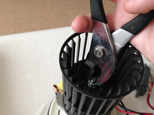

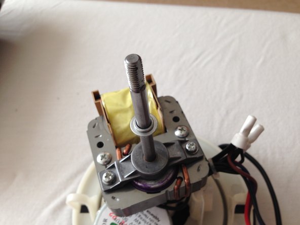

      • The bolt that you need to remove is inside of the pre-installed fan blades. With your pliers, grab a hold of the nut and twist to the RIGHT. This will allow you to remove the fan blades.
    7. Bionaire Mini Tower Fan Blade Replacement: crwdns2935265:07crwdnd2935265:01crwdnd2935265:03crwdne2935265:0 Bionaire Mini Tower Fan Blade Replacement: crwdns2935265:07crwdnd2935265:02crwdnd2935265:03crwdne2935265:0 Bionaire Mini Tower Fan Blade Replacement: crwdns2935265:07crwdnd2935265:03crwdnd2935265:03crwdne2935265:0

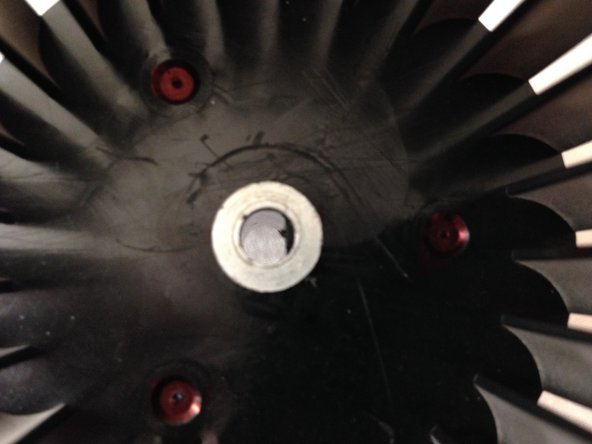

      • In order to install the new blades, there are two pieces that you have to match up. The blades and pole both have a flat side that you have to match up in order for the blades to stay on.
      • Make sure when you install the blades, it blows air when it rotates in a counterclockwise fashion.
    8. Bionaire Mini Tower Fan Blade Replacement: crwdns2935265:08crwdnd2935265:01crwdnd2935265:01crwdne2935265:0
      • Tighten the bolt to the left and you have successfully installed your new fan blades.
