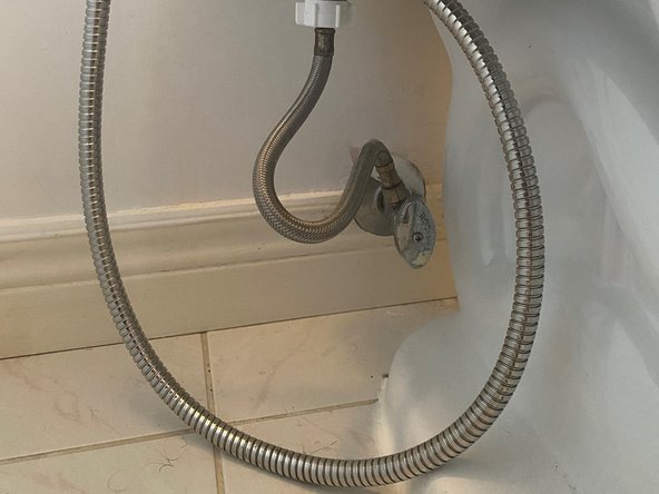

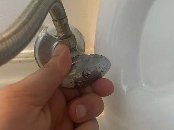

    • Turn off the main water valve under the toilet.
    • Rotate it clockwise until it is completely shut.

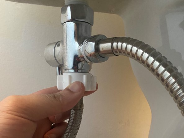

    • Disconnect the tee connector from the water supply by turning the knob counterclockwise.
    • Turn the knob counterclockwise to detach the tee connector from the toilet.
    • You may also flush out any water inside the bidet by straightening the hose and any water remaining will pour out of the end of the hose.

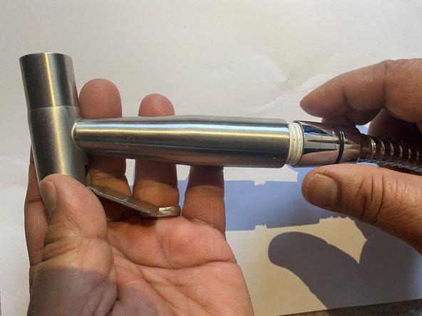

    • Unscrew the sprayer from the hose.
    • Unscrew the hose from the tee connector.

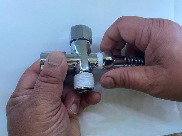

    • Attach the new/replacement hose with the tee connector. The valve should be on the opposite side.
    • Attach the hose to the sprayer.

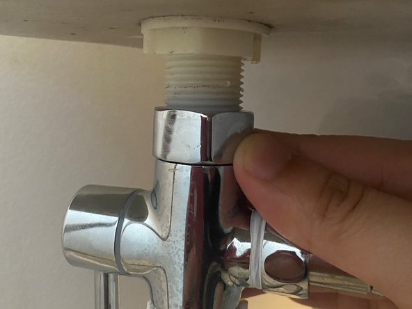

  6. Bidet Sprayer Hose Replacement: crwdns2935265:06crwdnd2935265:01crwdnd2935265:03crwdne2935265:0 Bidet Sprayer Hose Replacement: crwdns2935265:06crwdnd2935265:02crwdnd2935265:03crwdne2935265:0 Bidet Sprayer Hose Replacement: crwdns2935265:06crwdnd2935265:03crwdnd2935265:03crwdne2935265:0
    • Start by reattaching the tee connector to the toilet. Turn the knob clockwise.
    • Connect the tee connector to the main water supply line. Turn the knob counterclockwise.
