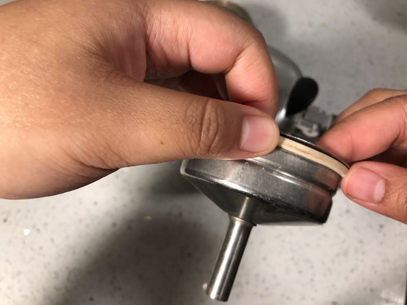

  3. Bialetti Mukka Express Gasket Replacement: crwdns2935265:03crwdnd2935265:01crwdnd2935265:03crwdne2935265:0 Bialetti Mukka Express Gasket Replacement: crwdns2935265:03crwdnd2935265:02crwdnd2935265:03crwdne2935265:0 Bialetti Mukka Express Gasket Replacement: crwdns2935265:03crwdnd2935265:03crwdnd2935265:03crwdne2935265:0
    • Take the rubber gasket off by rolling it all the way down.
  4. Bialetti Mukka Express Gasket Replacement: crwdns2935265:04crwdnd2935265:01crwdnd2935265:03crwdne2935265:0 Bialetti Mukka Express Gasket Replacement: crwdns2935265:04crwdnd2935265:02crwdnd2935265:03crwdne2935265:0 Bialetti Mukka Express Gasket Replacement: crwdns2935265:04crwdnd2935265:03crwdnd2935265:03crwdne2935265:0
    • Insert the new gasket by rolling it all the way up.
    • Make sure the new gasket is secure by straightening it out at the top of the filter.
