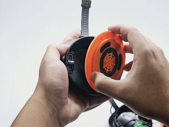

    • Twist the left speaker cushion towards you, and pull off the headset.

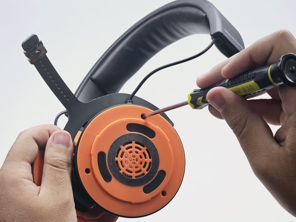

    • Using the 2.0mm Phillips-Head screwdriver, unscrew the two 0.6mm screws at the end of the left side headband.

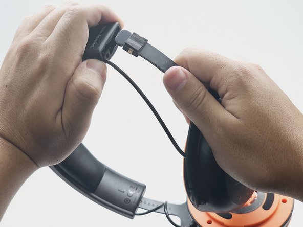

    • Hold open the top part of the headband. Slide out the left earphone.

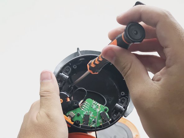

    • Using the 3.0mm Phillips-Head Screwdriver, unscrew the three 0.7 mm screws on the left speaker cover.

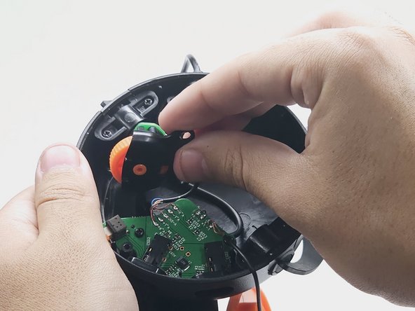

    • Using the 2.0mm Phillips-Head Screwdriver, unscrew the two 0.5mm screws on the volume control component.
  6. Beyerdynamic MMX100 Volume Controller Repair: crwdns2935265:06crwdnd2935265:01crwdnd2935265:03crwdne2935265:0 Beyerdynamic MMX100 Volume Controller Repair: crwdns2935265:06crwdnd2935265:02crwdnd2935265:03crwdne2935265:0 Beyerdynamic MMX100 Volume Controller Repair: crwdns2935265:06crwdnd2935265:03crwdnd2935265:03crwdne2935265:0

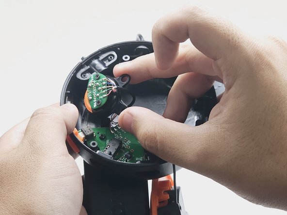

    • Take out, and flip over, the volume control component.
  7. Beyerdynamic MMX100 Volume Controller Repair: crwdns2935265:07crwdnd2935265:01crwdnd2935265:02crwdne2935265:0 Beyerdynamic MMX100 Volume Controller Repair: crwdns2935265:07crwdnd2935265:02crwdnd2935265:02crwdne2935265:0

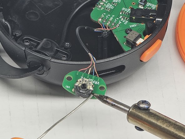

    • Using the 2.0mm Phillips-Head Screwdriver, unscrew the two 0.3mm screws on the board. Then, take off the volume wheel.
  8. Beyerdynamic MMX100 Volume Controller Repair: crwdns2935265:08crwdnd2935265:01crwdnd2935265:02crwdne2935265:0 Beyerdynamic MMX100 Volume Controller Repair: crwdns2935265:08crwdnd2935265:02crwdnd2935265:02crwdne2935265:0
    • Hazardous situation which, if not avoided, could result in minor or moderate injury.

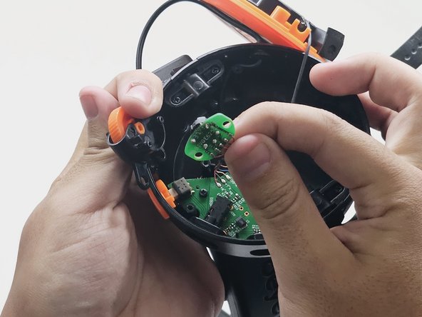

    • Using a soldering iron, desolder the damaged wires and the prongs on either side of the board.
