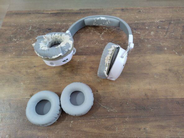

  1. Beyerdynamic Custom Street Earpads Replacement, Prepare your tools and replacement earpads: crwdns2935265:01crwdnd2935265:01crwdnd2935265:02crwdne2935265:0 Beyerdynamic Custom Street Earpads Replacement, Prepare your tools and replacement earpads: crwdns2935265:01crwdnd2935265:02crwdnd2935265:02crwdne2935265:0
    • Gather your headphones, the replacement earpads and your tools on a clean surface.

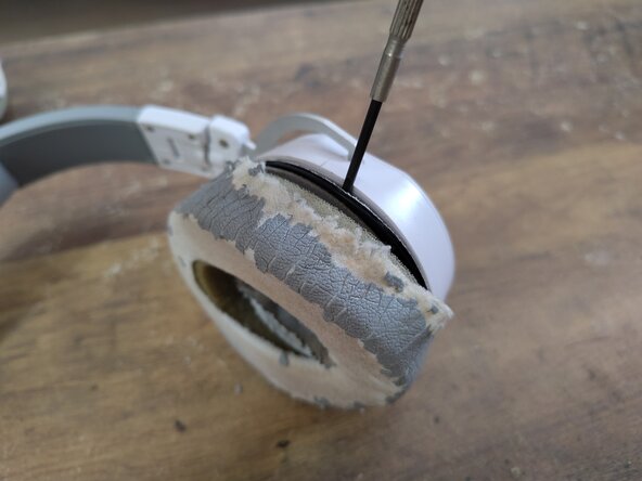

  2. Beyerdynamic Custom Street Earpads Replacement, Unclip the old earpads: crwdns2935265:02crwdnd2935265:01crwdnd2935265:02crwdne2935265:0 Beyerdynamic Custom Street Earpads Replacement, Unclip the old earpads: crwdns2935265:02crwdnd2935265:02crwdnd2935265:02crwdne2935265:0
    • Use the screwdriver to remove the old earpads. It should be easy to take it off: the earpads are just clipped on the headphones.
    • Don't force it: gently bend the screwdriver to unclip.

  4. Beyerdynamic Custom Street Earpads Replacement, Insert the plastic rings in your replacement earpads: crwdns2935265:04crwdnd2935265:01crwdnd2935265:03crwdne2935265:0 Beyerdynamic Custom Street Earpads Replacement, Insert the plastic rings in your replacement earpads: crwdns2935265:04crwdnd2935265:02crwdnd2935265:03crwdne2935265:0 Beyerdynamic Custom Street Earpads Replacement, Insert the plastic rings in your replacement earpads: crwdns2935265:04crwdnd2935265:03crwdnd2935265:03crwdne2935265:0
    • Use your hands and find your way to insert the plastic rings in your replacement earpads without ripping everything off. In my case, the replacement earpads looked a bit too little compared to the rings, but the rings eventually fitted in the new earpads.
