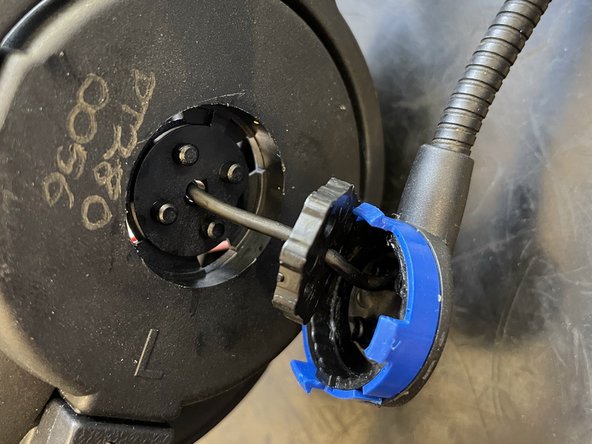

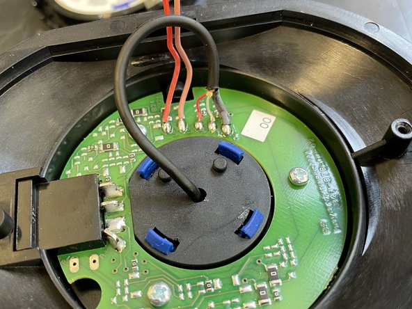

  4. Beyer Dynamic DT280/DT290 Microphone Teardown, Remove Blue Clip: crwdns2935265:04crwdnd2935265:01crwdnd2935265:01crwdne2935265:0
    • By pushing the blue clips towards the centre with a prying tool or something similar, the microphone boom arm is then released from the body of the ear piece.
  5. Beyer Dynamic DT280/DT290 Microphone Teardown, Remove the boom arm: crwdns2935265:05crwdnd2935265:01crwdnd2935265:03crwdne2935265:0 Beyer Dynamic DT280/DT290 Microphone Teardown, Remove the boom arm: crwdns2935265:05crwdnd2935265:02crwdnd2935265:03crwdne2935265:0 Beyer Dynamic DT280/DT290 Microphone Teardown, Remove the boom arm: crwdns2935265:05crwdnd2935265:03crwdnd2935265:03crwdne2935265:0
    • To remove the boom arm, it must be de-soldered from the PCB
