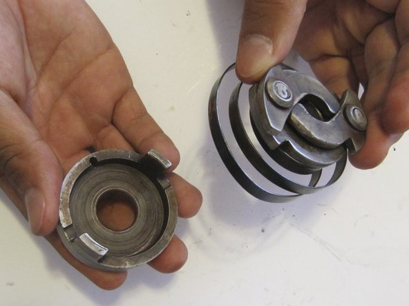

    • Use a 9/16 wrench to unscrew the nut on the drive shaft.
  2. Bendix Magneto Woodruff Key: crwdns2935265:02crwdnd2935265:01crwdnd2935265:01crwdne2935265:0
    • Remove the lock washer underneath the nut.
  3. Bendix Magneto Woodruff Key: crwdns2935265:03crwdnd2935265:01crwdnd2935265:02crwdne2935265:0 Bendix Magneto Woodruff Key: crwdns2935265:03crwdnd2935265:02crwdnd2935265:02crwdne2935265:0
    • Pull away the impulse coupling.
  4. Bendix Magneto Woodruff Key, Woodruff Key: crwdns2935265:04crwdnd2935265:01crwdnd2935265:01crwdne2935265:0
    • Use a pliers to remove the Woodruff key.
    • If the key seems stuck, use a #2 Flathead screwdriver to unjam the key.
