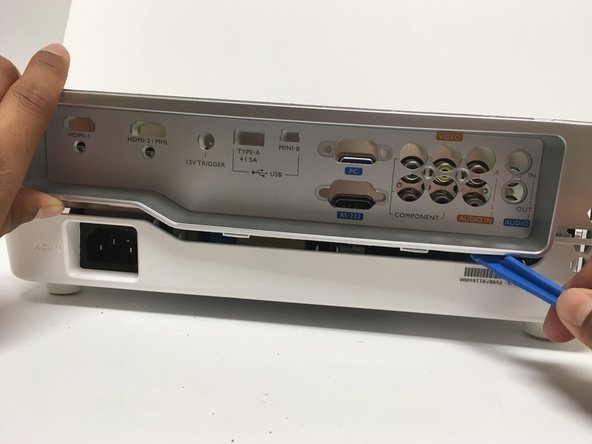

  10. BenQ HT1075 Projector Circuit Board Replacement: crwdns2935265:010crwdnd2935265:01crwdnd2935265:03crwdne2935265:0 BenQ HT1075 Projector Circuit Board Replacement: crwdns2935265:010crwdnd2935265:02crwdnd2935265:03crwdne2935265:0 BenQ HT1075 Projector Circuit Board Replacement: crwdns2935265:010crwdnd2935265:03crwdnd2935265:03crwdne2935265:0
    • Remove these four 8.5 mm Phillips #1 screws using a Phillips #1 (PH1) screwdriver.
    • Afterwards, use a 5mm nut driver to remove the four remaining screws.
    • Use the opening tool to loosen the back cover then pull it off.

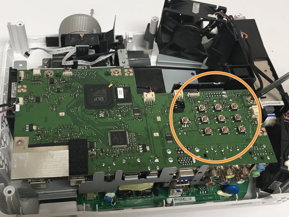

  12. BenQ HT1075 Projector Circuit Board Replacement: crwdns2935265:012crwdnd2935265:01crwdnd2935265:02crwdne2935265:0 BenQ HT1075 Projector Circuit Board Replacement: crwdns2935265:012crwdnd2935265:02crwdnd2935265:02crwdne2935265:0
    • Using the Phillips #1 (PH1) screwdriver, remove the three 6.3 mm Phillips #1 screws holding down the circuit board.
    • Carefully pull the circuit board from the frame, adding force to the area where the pushbuttons are located.
