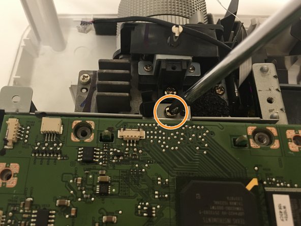

    • Unscrew the Philips #1 (PH1) screw securing the green wire located at the bottom left of the metal casing.
    • Remove a second Philips #1 (PH1) screw that holds down the top of the metal casing located near the back of the projector’s lens.
