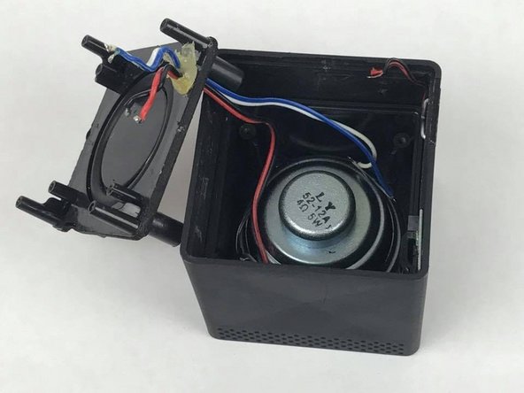

  3. Bem Wireless HL2739B Speaker Replacement: crwdns2935265:03crwdnd2935265:01crwdnd2935265:01crwdne2935265:0
    • Lift the bottom cover away from the rest of the speaker.
    • There are wires connecting the battery and cover to the rest of the speaker. Be careful when removing the base cover.
    • Using the tweezers, pull the wires from the speaker's internal chip.
    • Be careful not to damage the chip when you remove the wires.
    • It will likely require soldering to reassemble the speaker after this step.

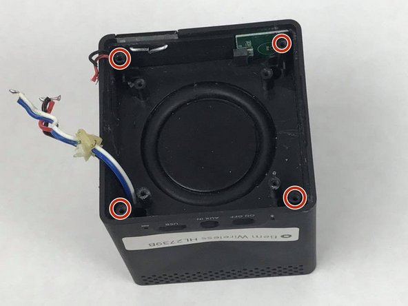

  6. Bem Wireless HL2739B Speaker Replacement, Speaker Motherboard: crwdns2935265:06crwdnd2935265:01crwdnd2935265:02crwdne2935265:0 Bem Wireless HL2739B Speaker Replacement, Speaker Motherboard: crwdns2935265:06crwdnd2935265:02crwdnd2935265:02crwdne2935265:0
    • Unscrew the four 10mm screws from the motherboard.

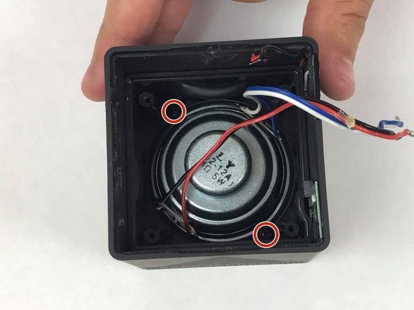

  9. Bem Wireless HL2739B Speaker Replacement, Speaker: crwdns2935265:09crwdnd2935265:01crwdnd2935265:01crwdne2935265:0
    • Using tweezers remove excess glue that may be covering the screw holes of the speaker's driver.
  10. Bem Wireless HL2739B Speaker Replacement: crwdns2935265:010crwdnd2935265:01crwdnd2935265:02crwdne2935265:0 Bem Wireless HL2739B Speaker Replacement: crwdns2935265:010crwdnd2935265:02crwdnd2935265:02crwdne2935265:0
    • Remove the four 10mm screws from speaker's base.
  11. Bem Wireless HL2739B Speaker Replacement: crwdns2935265:011crwdnd2935265:01crwdnd2935265:02crwdne2935265:0 Bem Wireless HL2739B Speaker Replacement: crwdns2935265:011crwdnd2935265:02crwdnd2935265:02crwdne2935265:0
    • Using the metal spudger, pry up on the speaker's base.
    • This will require a moderate amount of force.
    • Pull the wire from the speaker's driver's base from the hole it was in.
  12. Bem Wireless HL2739B Speaker Replacement: crwdns2935265:012crwdnd2935265:01crwdnd2935265:02crwdne2935265:0 Bem Wireless HL2739B Speaker Replacement: crwdns2935265:012crwdnd2935265:02crwdnd2935265:02crwdne2935265:0
    • Remove the two 5mm screws from the speaker.
    • Lift the driver from the speaker.
