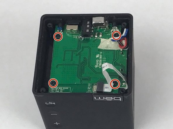

  6. Bem Wireless HL2739B  Speaker Motherboard Replacement, Speaker Motherboard: crwdns2935265:06crwdnd2935265:01crwdnd2935265:02crwdne2935265:0 Bem Wireless HL2739B  Speaker Motherboard Replacement, Speaker Motherboard: crwdns2935265:06crwdnd2935265:02crwdnd2935265:02crwdne2935265:0
    • Unscrew the four 10mm screws from the motherboard.

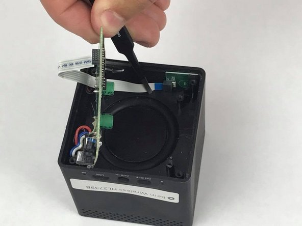

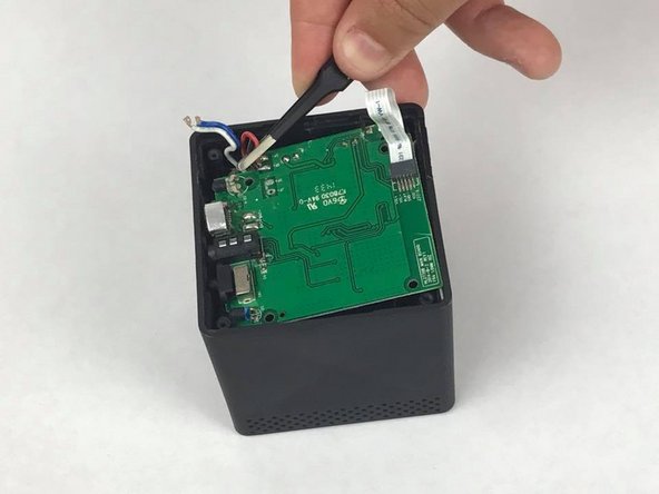

  7. Bem Wireless HL2739B  Speaker Motherboard Replacement: crwdns2935265:07crwdnd2935265:01crwdnd2935265:02crwdne2935265:0 Bem Wireless HL2739B  Speaker Motherboard Replacement: crwdns2935265:07crwdnd2935265:02crwdnd2935265:02crwdne2935265:0
    • Using tweezers, remove the blue/white and red/black wires from motherboard.
  8. Bem Wireless HL2739B  Speaker Motherboard Replacement: crwdns2935265:08crwdnd2935265:01crwdnd2935265:02crwdne2935265:0 Bem Wireless HL2739B  Speaker Motherboard Replacement: crwdns2935265:08crwdnd2935265:02crwdnd2935265:02crwdne2935265:0
    • Gently re-position the motherboard so you can access the bus wire connected to the speaker.
    • Remove bus wire from the speaker and lift out the motherboard.
