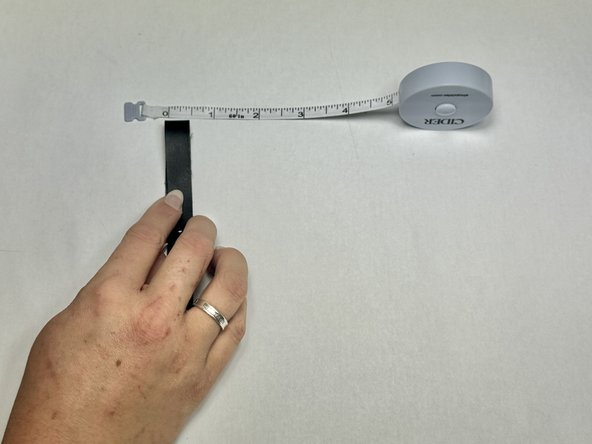

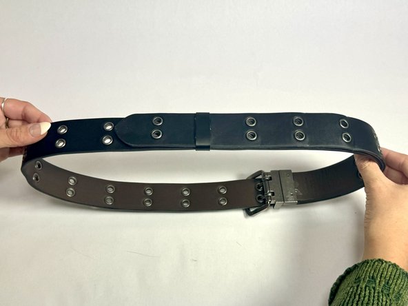

      • Measure the pieces of leather so the resulting strap will wrap around with a width of 0.5 in and a 1 cm overlap.

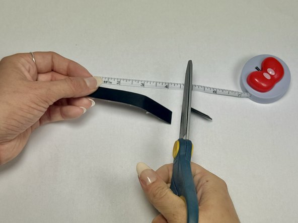

    2. Belt Loop Keeper Replacement: crwdns2935265:02crwdnd2935265:01crwdnd2935265:02crwdne2935265:0 Belt Loop Keeper Replacement: crwdns2935265:02crwdnd2935265:02crwdnd2935265:02crwdne2935265:0
      • Mark the measurements with an indent.
      • Our belt was 1.5 in wide; the leather strap we measured was 4 x 0.5 in.
      • Cut the leather strap using scissors or a pocket knife.
      • Caution: Hazardous situation which, if not avoided, could result in minor or moderate injury.

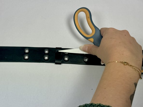

    3. Belt Loop Keeper Replacement: crwdns2935265:03crwdnd2935265:01crwdnd2935265:02crwdne2935265:0 Belt Loop Keeper Replacement: crwdns2935265:03crwdnd2935265:02crwdnd2935265:02crwdne2935265:0
      • Wrap the leather strap around the belt with 1 cm of overlap.
      • Mark the area underneath where the leather piece will overlap to center the eyelet.
    4. Belt Loop Keeper Replacement: crwdns2935265:04crwdnd2935265:01crwdnd2935265:01crwdne2935265:0

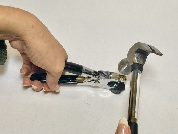

      • Place an eyelet on the inner flat side of the eyelet pliers.
    5. Belt Loop Keeper Replacement: crwdns2935265:05crwdnd2935265:01crwdnd2935265:02crwdne2935265:0 Belt Loop Keeper Replacement: crwdns2935265:05crwdnd2935265:02crwdnd2935265:02crwdne2935265:0
      • Placing the loop of leather in between the pliers, center the eyelet on the indent previously made and press down firmly.
      • Use a hammer to strike the outside of the pliers for additional force.
    6. Belt Loop Keeper Replacement: crwdns2935265:06crwdnd2935265:01crwdnd2935265:03crwdne2935265:0 Belt Loop Keeper Replacement: crwdns2935265:06crwdnd2935265:02crwdnd2935265:03crwdne2935265:0 Belt Loop Keeper Replacement: crwdns2935265:06crwdnd2935265:03crwdnd2935265:03crwdne2935265:0

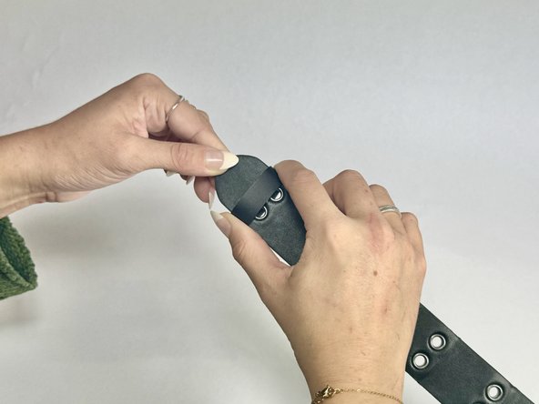

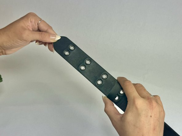

      • Make sure both sides of the leather loop are secured.
      • Insert the belt tail into the leather loop.
      • Slide down the desired belt.
    7. Belt Loop Keeper Replacement: crwdns2935265:07crwdnd2935265:01crwdnd2935265:02crwdne2935265:0 Belt Loop Keeper Replacement: crwdns2935265:07crwdnd2935265:02crwdnd2935265:02crwdne2935265:0
      • Buckle the belt and insert the excess belt material into the belt loop keeper.
      • Adjust until satisfied.
