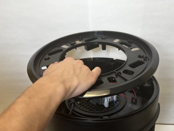

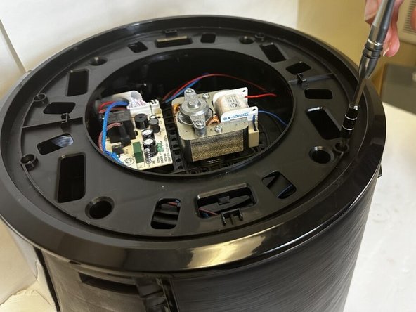

    • Use a spudger to pry off the metal top of the air fryer.
  2. Bella TXG-FS075A Touchscreen Replacement: crwdns2935265:02crwdnd2935265:01crwdnd2935265:02crwdne2935265:0 Bella TXG-FS075A Touchscreen Replacement: crwdns2935265:02crwdnd2935265:02crwdnd2935265:02crwdne2935265:0
    • Use an iFixit opening tool to pry off the plastic frame.

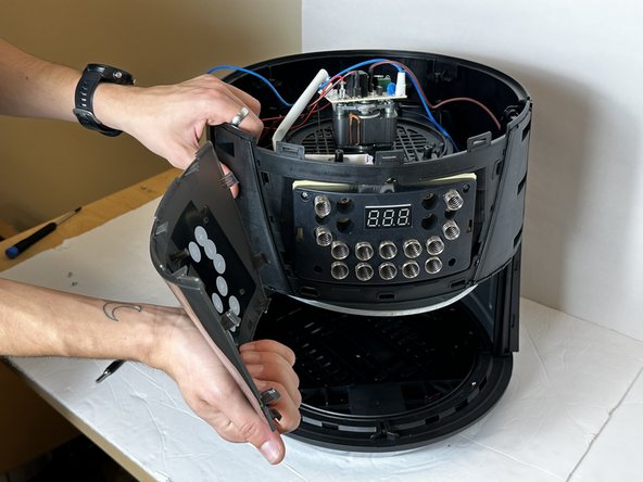

  3. Bella TXG-FS075A Touchscreen Replacement: crwdns2935265:03crwdnd2935265:01crwdnd2935265:03crwdne2935265:0 Bella TXG-FS075A Touchscreen Replacement: crwdns2935265:03crwdnd2935265:02crwdnd2935265:03crwdne2935265:0 Bella TXG-FS075A Touchscreen Replacement: crwdns2935265:03crwdnd2935265:03crwdnd2935265:03crwdne2935265:0
    • Remove the four 13 mm screws from the second plastic frame using a Phillips #2 screwdriver.
    • Pry off the black plastic frame.

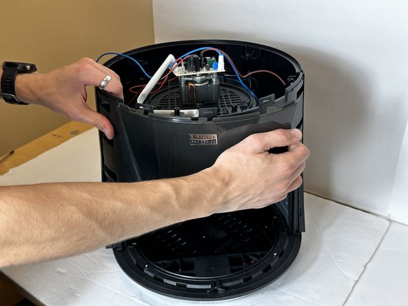

  4. Bella TXG-FS075A Touchscreen Replacement: crwdns2935265:04crwdnd2935265:01crwdnd2935265:03crwdne2935265:0 Bella TXG-FS075A Touchscreen Replacement: crwdns2935265:04crwdnd2935265:02crwdnd2935265:03crwdne2935265:0 Bella TXG-FS075A Touchscreen Replacement: crwdns2935265:04crwdnd2935265:03crwdnd2935265:03crwdne2935265:0
    • Remove the singular 13 mm screw using a Phillips #2 screwdriver.
    • Slowly lift the sides of the screen from the body of the air fryer until all corners are loose.
