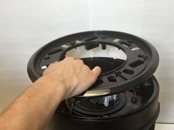

    • Use an iFixit opening tool to pry off the plastic frame.

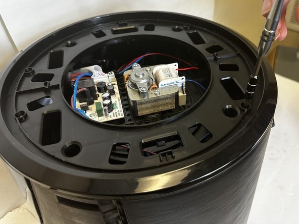

    • Remove the four 13 mm screws from the second plastic frame using a Phillips #2 screwdriver.
    • Pry off the black plastic frame.

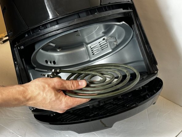

    • Using a spudger, pry off the outer frame.
    • Pull up on the outer frame, exposing the inner wall of the fryer.
  6. Bella TXG-FS075A Heating Element Replacement: crwdns2935265:06crwdnd2935265:01crwdnd2935265:02crwdne2935265:0 Bella TXG-FS075A Heating Element Replacement: crwdns2935265:06crwdnd2935265:02crwdnd2935265:02crwdne2935265:0
    • Remove the 13 mm screw connecting to the heating element's bracket using a Phillips #2 screwdriver.
  7. Bella TXG-FS075A Heating Element Replacement: crwdns2935265:07crwdnd2935265:01crwdnd2935265:02crwdne2935265:0 Bella TXG-FS075A Heating Element Replacement: crwdns2935265:07crwdnd2935265:02crwdnd2935265:02crwdne2935265:0
    • Pull out the heating element.
