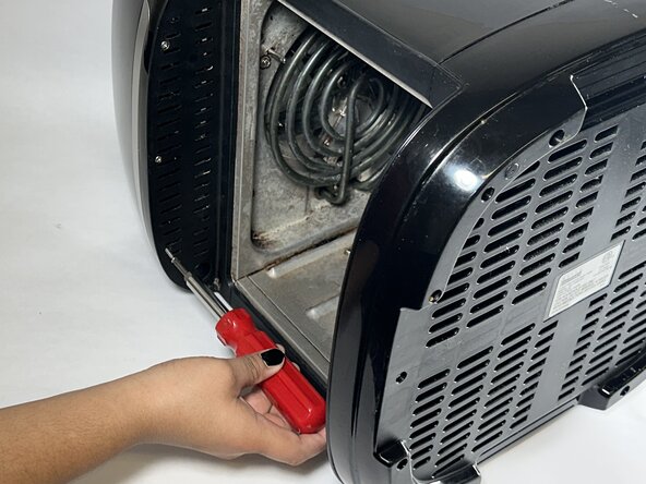

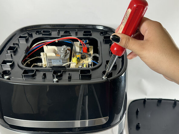

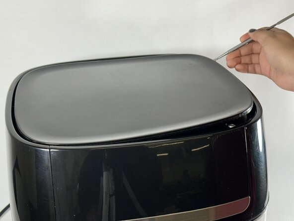

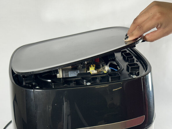

    • Use the metal spudger to pry off the protective lid on all four sides.
  3. Bella Pro 90246 Light Bulb Replacement: crwdns2935265:03crwdnd2935265:01crwdnd2935265:02crwdne2935265:0 Bella Pro 90246 Light Bulb Replacement: crwdns2935265:03crwdnd2935265:02crwdnd2935265:02crwdne2935265:0

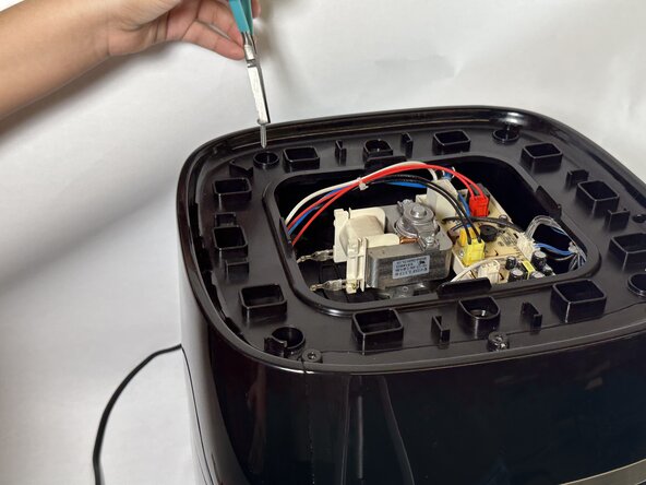

    • Remove the three 9.5 mm screws on the top of the air fryer that hold the plastic cover in place using a Phillips #1 screwdriver.
  4. Bella Pro 90246 Light Bulb Replacement: crwdns2935265:04crwdnd2935265:01crwdnd2935265:03crwdne2935265:0 Bella Pro 90246 Light Bulb Replacement: crwdns2935265:04crwdnd2935265:02crwdnd2935265:03crwdne2935265:0 Bella Pro 90246 Light Bulb Replacement: crwdns2935265:04crwdnd2935265:03crwdnd2935265:03crwdne2935265:0

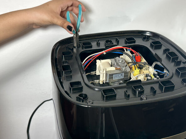

    • Use the Phillips #1 screwdriver to remove the four 34.9 mm screws that are located inside the round holes on the corners of the plastic cover.
    • You may need to use a pair of needle nose pliers to remove the screws from the deep set holes.

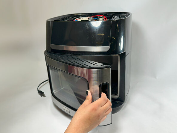

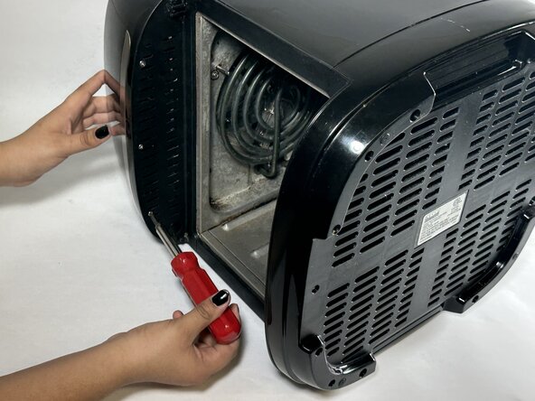

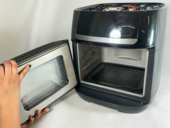

    • Open the door.
  6. Bella Pro 90246 Light Bulb Replacement: crwdns2935265:06crwdnd2935265:01crwdnd2935265:03crwdne2935265:0 Bella Pro 90246 Light Bulb Replacement: crwdns2935265:06crwdnd2935265:02crwdnd2935265:03crwdne2935265:0 Bella Pro 90246 Light Bulb Replacement: crwdns2935265:06crwdnd2935265:03crwdnd2935265:03crwdne2935265:0

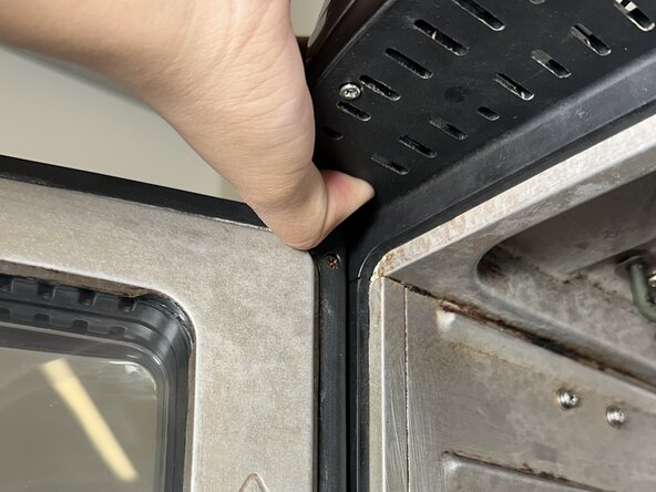

    • Press the button underneath the hood to release the mechanism that holds the door in place.
    • Once the door is disconnected, remove it from the airfryer and set it to the side.

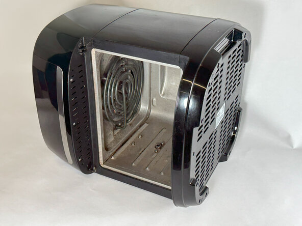

    • Carefully tilt the air fryer onto its side.
  8. Bella Pro 90246 Light Bulb Replacement: crwdns2935265:08crwdnd2935265:01crwdnd2935265:03crwdne2935265:0 Bella Pro 90246 Light Bulb Replacement: crwdns2935265:08crwdnd2935265:02crwdnd2935265:03crwdne2935265:0 Bella Pro 90246 Light Bulb Replacement: crwdns2935265:08crwdnd2935265:03crwdnd2935265:03crwdne2935265:0

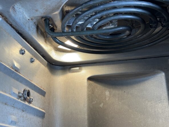

    • Use the Phillips #1 screwdriver to remove the three 25.4 mm screws under the hood.

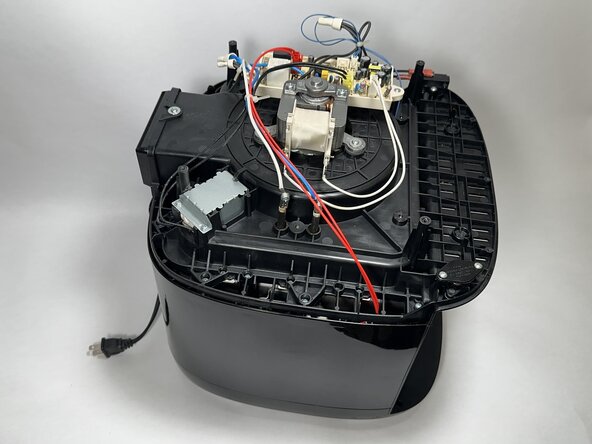

    • Hold the top of the air fryer into place while carefully moving it back to its up-right position.
    • After removing the screws, the top will be loose. Hold firmly to avoid damage to any wire connections underneath the plastic cover.

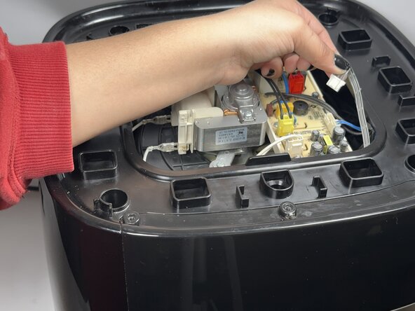

  10. Bella Pro 90246 Light Bulb Replacement: crwdns2935265:010crwdnd2935265:01crwdnd2935265:03crwdne2935265:0 Bella Pro 90246 Light Bulb Replacement: crwdns2935265:010crwdnd2935265:02crwdnd2935265:03crwdne2935265:0 Bella Pro 90246 Light Bulb Replacement: crwdns2935265:010crwdnd2935265:03crwdnd2935265:03crwdne2935265:0

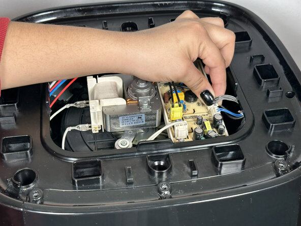

    • Identify the grey electrical cable attached to the circuit board.
    • Press firmly on the cable head's tab to release the connection.
    • Carefully wiggle the cable head to disconnect the wire from the circuit board without damaging it.
  11. Bella Pro 90246 Light Bulb Replacement: crwdns2935265:011crwdnd2935265:01crwdnd2935265:02crwdne2935265:0 Bella Pro 90246 Light Bulb Replacement: crwdns2935265:011crwdnd2935265:02crwdnd2935265:02crwdne2935265:0
    • Lift the top cover off of the air fryer to access the electrical circuits underneath.

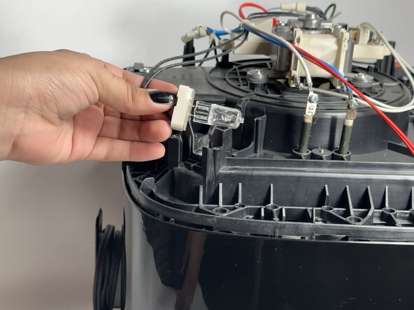

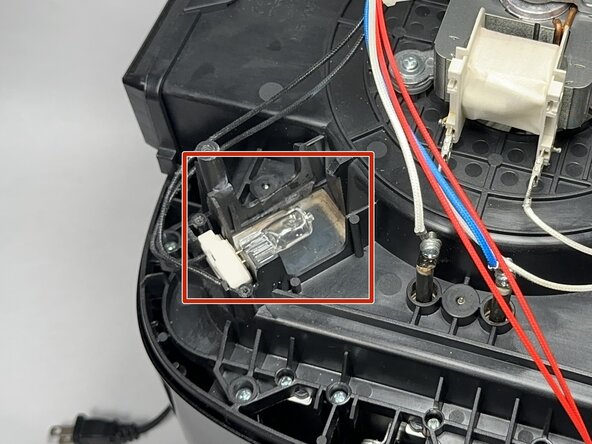

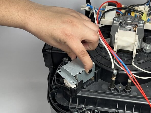

    • Remove the two 19.1 mm screws securing the metal light bulb cover using a Phillips #1 screwdriver.
    • Carefully pull off the metal cover to reveal the burnt-out light bulb.

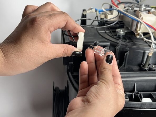

  13. Bella Pro 90246 Light Bulb Replacement: crwdns2935265:013crwdnd2935265:01crwdnd2935265:03crwdne2935265:0 Bella Pro 90246 Light Bulb Replacement: crwdns2935265:013crwdnd2935265:02crwdnd2935265:03crwdne2935265:0 Bella Pro 90246 Light Bulb Replacement: crwdns2935265:013crwdnd2935265:03crwdnd2935265:03crwdne2935265:0

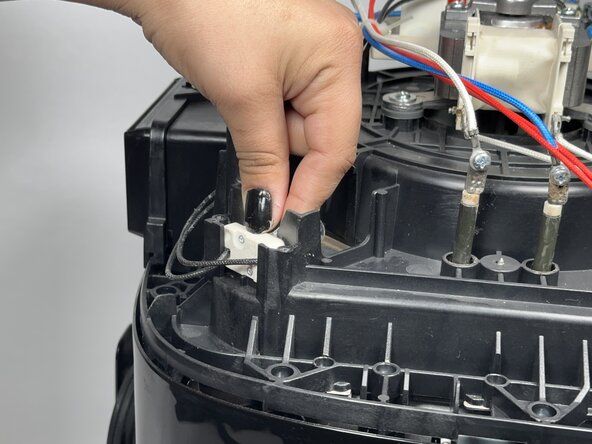

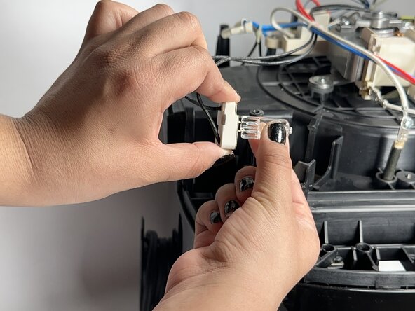

    • The light bulb is made of glass and can be fragile. Handle with care to avoid injuring yourself with broken shards of glass.

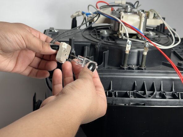

    • Lift the light bulb circuit out of the plastic slot and remove the burnt out light bulb by pulling gently.
  14. Bella Pro 90246 Light Bulb Replacement: crwdns2935265:014crwdnd2935265:01crwdnd2935265:03crwdne2935265:0 Bella Pro 90246 Light Bulb Replacement: crwdns2935265:014crwdnd2935265:02crwdnd2935265:03crwdne2935265:0 Bella Pro 90246 Light Bulb Replacement: crwdns2935265:014crwdnd2935265:03crwdnd2935265:03crwdne2935265:0
    • Gently plug the new light bulb into the light bulb circuit.
