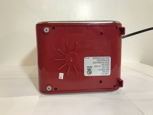

    • Set the coffee maker on its left side so the bottom is accessible.
    • Be sure to set the coffee maker on its left side, as this will make it easier for you to locate the water tube valve in later steps.
    • Rotate the coffee maker clockwise until the bottom panel is facing you.

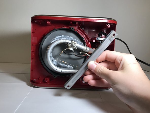

    • Remove the bottom panel by pulling it towards you using the square tabs located on the right side of the panel.
    • You may have to use more force than anticipated, and will hear a pop or snap when the panel opens.

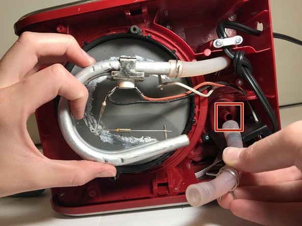

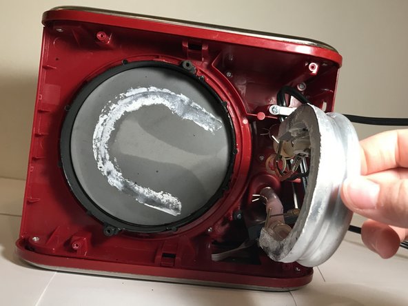

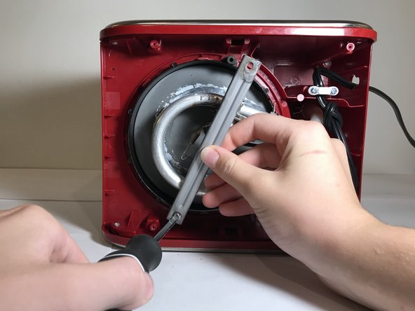

    • Use a Phillips #1 screwdriver to remove the two 3mm screws holding the curved metal tube in place.
  7. Bella Linea CM1075T-ET  Water Tube Valve Replacement: crwdns2935265:07crwdnd2935265:01crwdnd2935265:03crwdne2935265:0 Bella Linea CM1075T-ET  Water Tube Valve Replacement: crwdns2935265:07crwdnd2935265:02crwdnd2935265:03crwdne2935265:0 Bella Linea CM1075T-ET  Water Tube Valve Replacement: crwdns2935265:07crwdnd2935265:03crwdnd2935265:03crwdne2935265:0

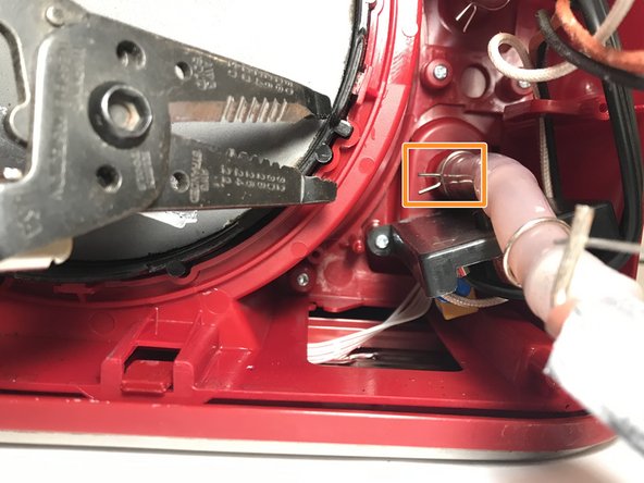

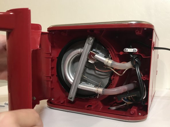

    • The water tube valve is the clear tube with parts inside of it, and is connected to the bottom of the curved metal tube. Be sure to remove this tube and not the clear tube that is hollow, which is connected to the top of the metal tube.
    • Use pliers to pinch and remove the clamp holding the water tube valve onto the metal tube.
    • Rotate the metal tube to the right so it is perpendicular to the bottom of the coffee maker.
    • Use pliers to pinch and remove the second clamp attaching the water tube valve to the connection of the water dispenser.
    • Be sure to reattach the hose clamps when reassembling. This reduces the potential risk of leaks.
  8. Bella Linea CM1075T-ET  Water Tube Valve Replacement: crwdns2935265:08crwdnd2935265:01crwdnd2935265:03crwdne2935265:0 Bella Linea CM1075T-ET  Water Tube Valve Replacement: crwdns2935265:08crwdnd2935265:02crwdnd2935265:03crwdne2935265:0 Bella Linea CM1075T-ET  Water Tube Valve Replacement: crwdns2935265:08crwdnd2935265:03crwdnd2935265:03crwdne2935265:0

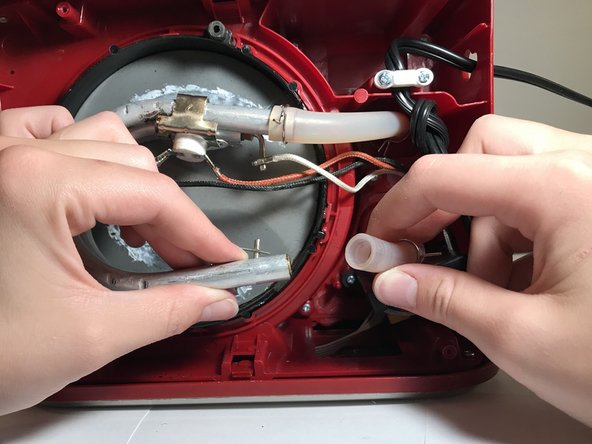

    • Detach the water tube valve from the metal tube.
    • Detach the water tube valve from the water dispenser connector.
    • Before attaching the new water tube valve, test which way the valve allows water to flow. Try blowing air into one end of the tube. The end that you were able to blow air through connects to the metal tube.
