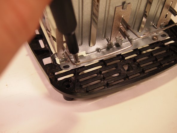

    • Using the Triangle #2 screwdriver, remove four 100.0 mm screws from the base of the toaster.

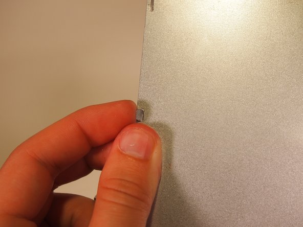

    • Unfold the four tabs that hold on the top cover to the toaster
    • In the next few steps you will be unfolding a lot of the metal tabs - you can either use your hand or the metal spudger to do so
    • Many of the metal tabs are very fragile - be very careful when you unfold them or they will break!

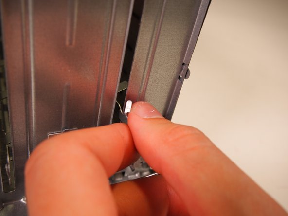

    • Unfold the two tabs on the back of the toaster.

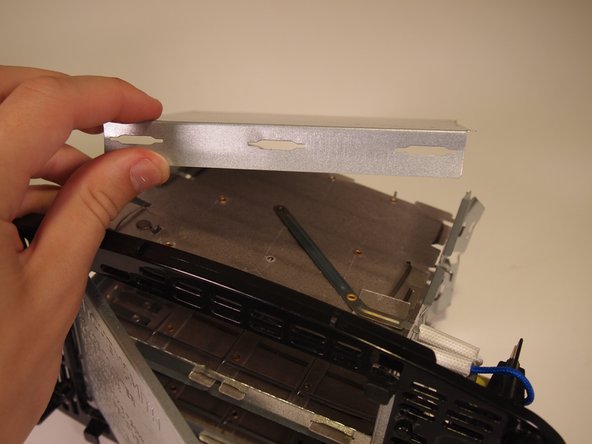

    • Unfold the two tabs on the top of the toaster that hold the central bar in place.
  13. Bella KitchenSmith 2 Slice Toaster 12082 Disassembly: crwdns2935265:013crwdnd2935265:01crwdnd2935265:02crwdne2935265:0 Bella KitchenSmith 2 Slice Toaster 12082 Disassembly: crwdns2935265:013crwdnd2935265:02crwdnd2935265:02crwdne2935265:0

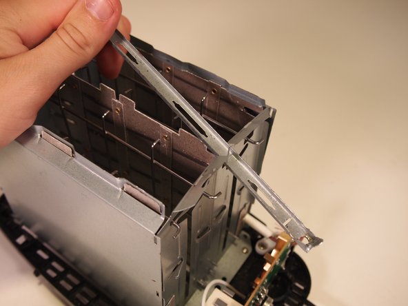

    • Remove the central bar.
  14. Bella KitchenSmith 2 Slice Toaster 12082 Disassembly: crwdns2935265:014crwdnd2935265:01crwdnd2935265:02crwdne2935265:0 Bella KitchenSmith 2 Slice Toaster 12082 Disassembly: crwdns2935265:014crwdnd2935265:02crwdnd2935265:02crwdne2935265:0

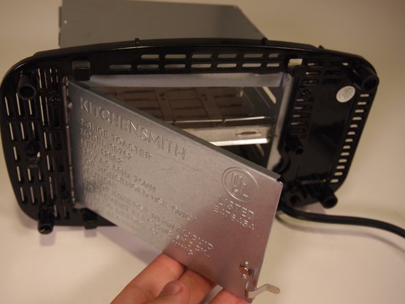

    • Using the Phillips #1 screwdriver, remove the two 8.0 mm screws from the backside of the toaster.
  20. Bella KitchenSmith 2 Slice Toaster 12082 Disassembly: crwdns2935265:020crwdnd2935265:01crwdnd2935265:01crwdne2935265:0
    • Undo the two tabs on the backside of the toaster.
  21. Bella KitchenSmith 2 Slice Toaster 12082 Disassembly: crwdns2935265:021crwdnd2935265:01crwdnd2935265:01crwdne2935265:0
    • Slightly pull the back panel of the toaster away from the device.
    • Do not try to attempt to completely remove the back panel - there are wires attached to the back panel that are still attached to the main body of the toaster - any attempt to completely remove the back panel could result in breaking your toaster!
