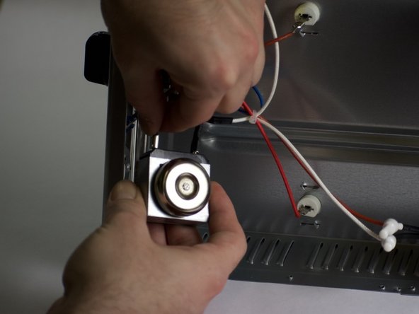

  10. Bella 4-Slice Toaster Oven Timer Replacement: crwdns2935265:010crwdnd2935265:01crwdnd2935265:02crwdne2935265:0 Bella 4-Slice Toaster Oven Timer Replacement: crwdns2935265:010crwdnd2935265:02crwdnd2935265:02crwdne2935265:0
    • Remove two 5.91 mm #2 Phillips screws which secure the timer to the toaster.

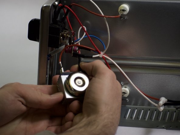

  11. Bella 4-Slice Toaster Oven Timer Replacement: crwdns2935265:011crwdnd2935265:01crwdnd2935265:03crwdne2935265:0 Bella 4-Slice Toaster Oven Timer Replacement: crwdns2935265:011crwdnd2935265:02crwdnd2935265:03crwdne2935265:0 Bella 4-Slice Toaster Oven Timer Replacement: crwdns2935265:011crwdnd2935265:03crwdnd2935265:03crwdne2935265:0
    • Inside the device, unplug the red and black wires from the top of the timer.
  12. Bella 4-Slice Toaster Oven Timer Replacement: crwdns2935265:012crwdnd2935265:01crwdnd2935265:01crwdne2935265:0
    • Remove timer from device interior.
